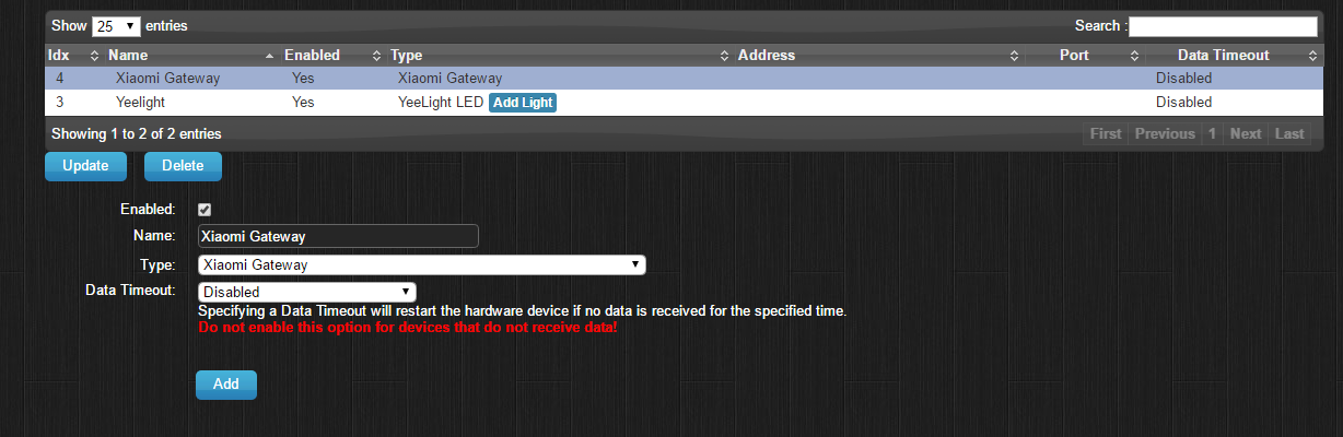

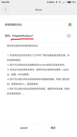

I've added Gateway as in instruction https://www.domoticz.com/wiki/Xiaomi_Gateway_(Aqara) but nothing appeared in "Devices". With Yeelight bulbs it's all ok. I need to enter this password somewhere?
Sorry for noob question) May be i need to download any plugin? I use the latest beta.
levynger
Posts: 87
Joined: Wednesday 21 December 2016 19:03
Location: Israel
Post by levynger »
ZEMI wrote:I've added Gateway as in instruction https://www.domoticz.com/wiki/Xiaomi_Gateway_(Aqara) but nothing appeared in "Devices". With Yeelight bulbs it's all ok. I need to enter this password somewhere?
No password needed.

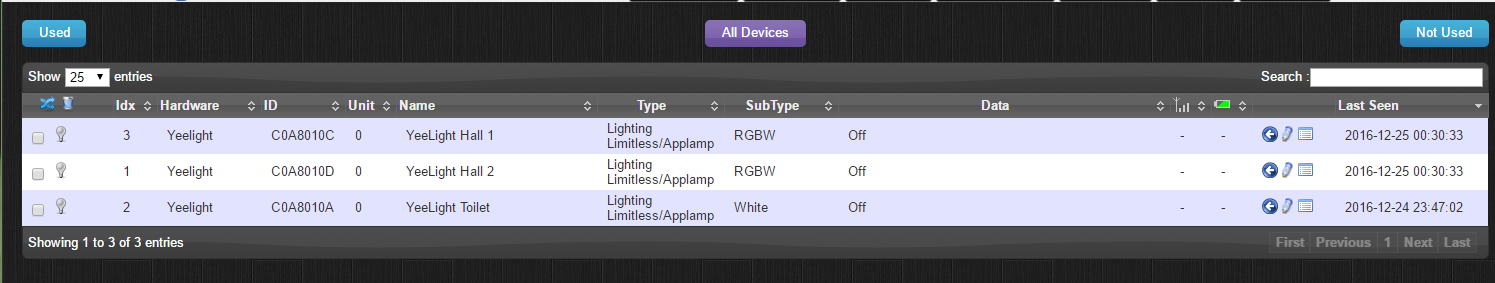

did you go to "Switches" tab and press Learn Light/Switch ? you have 5 seconds to press the switch, or buttons on the MI sensors (door, motion etc)
it should recognize them during the learning time appears on screen.
ZEMI
Joined: Thursday 22 December 2016 18:53
Post by ZEMI »
I've tried, but nothing, it even doesn't see gateway. May be i can set somewhere is't IP manually?
icibt
Posts: 6
Joined: Sunday 25 December 2016 22:16
Post by icibt »
I have the same problem. Added my Yeelight's without a problem... but can't add my Gateway. Did you found a solution?

ZEMI
Post by ZEMI »
icibt wrote: I have the same problem. Added my Yeelight's without a problem... but can't add my Gateway. Did you found a solution?
No, i don't, also Windows 10 x64
