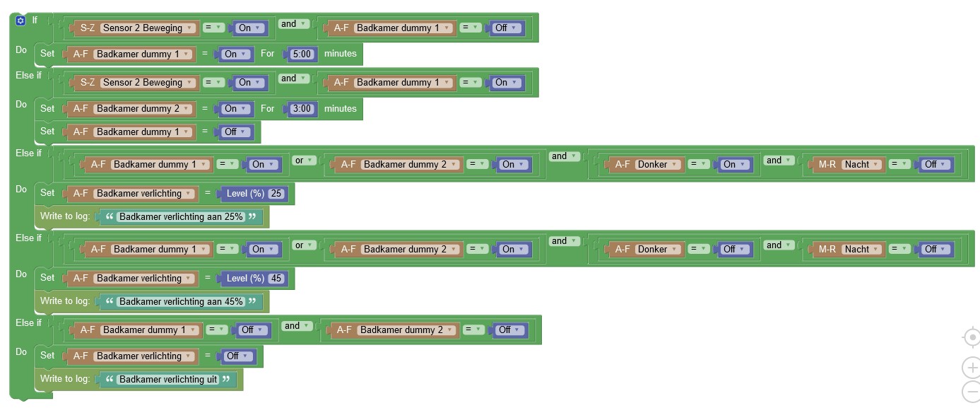

This works for me
(but my wife doesn't like it so it is now switched off)
Only dim values depending on the "dark on" and "dark off" value. Dim value depending on the "dark on" and "dark off" value and use of a motion sensor:

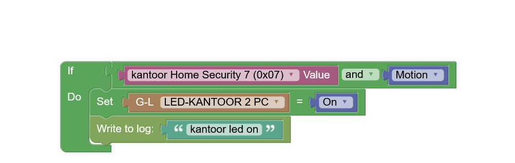

I have an Aeotec ZWA005 TriSensor+ here and would like the motion sensor to switch on my LED lamp when I enter my office and, for example, if I am away for 10 minutes, to switch it off again.
it is not possible to get this working

Is every function separate visual in Domoticz? Or just only PIR function?teo1966 wrote:I have an Aeotec ZWA005 TriSensor+ here and would like the motion sensor to switch on my LED lamp when I enter my office and, for example, if I am away for 10 minutes, to switch it off again.
Where you from?

Ok, will you Try the command ‘on’ in stead of ‘motion’ if you can switch the lamp on.
I will think about it and send you a PB after your replay for the next answer.

Re: Blockly examples
does not work

I send you a PB.

In the event editor there you can see all the devices with the current state they have. Check the state change and see what you have to use in your Blockly statement.

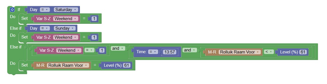

I made the folowing script but get an error in my logging and the script does not work:
I tried with: if day= Saturday or day=Sunday instead of the Variable but that gives the same error.
The error in my log :
Error: EventSystem: Lua script error (Blockly), Name: Rolluik voor Open weekend_3 => [string "result = 0; weekday = os.date('*t')['wday']; ..."]:1: attempt to compare string with number
