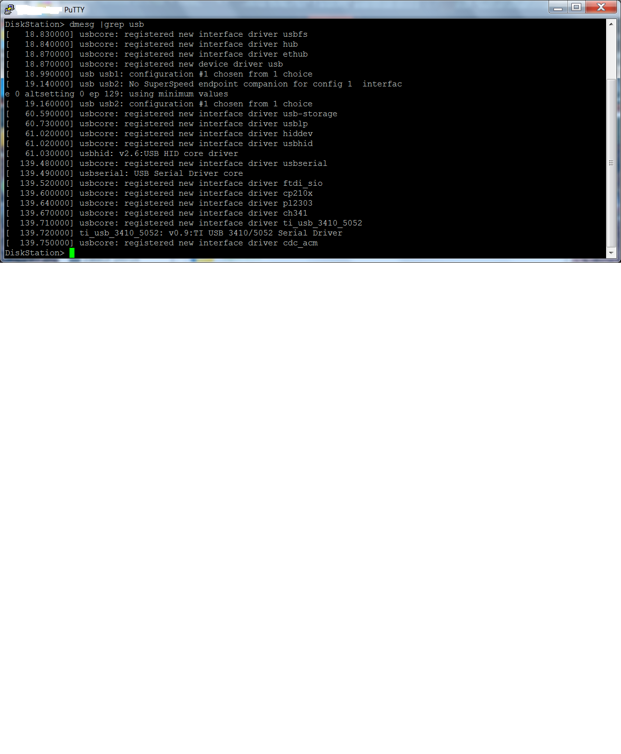

jumbo70
Joined: Monday 25 January 2016 22:23
Re: domoticz in synology as package! Available now.
Post by jumbo70 »
@jumbotroll,
Thanks for the support. Unfortunately I can't get it to work.
The aeotec stick is blinking, but does not show up in the external devices list nor do I see it as serial port within domoticz when selecting openzwave usb.
I added output of dmesg |grep usb. Maybe that might help.
PS, some other memory usb sticks pop-up immediately as external devices.
Thanks,
jumbo70
dmesg after installation and restart 3.png (130.72 KiB) Viewed 3464 times
