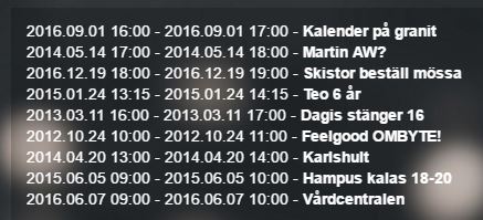

It seems to be a Internet Explorer "bug", just walked by my wallmounted iPad and there was the calendar :D and it seems to work in Chrome as well. (worked in IE before the update)
But the output looks lite random calendar objects from 2014 until now.

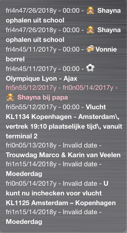

I tried the
maxitems: 5, ......
but that doesn't work (yet ?).
Also, I see some strange behaviour (see attachment): recurring events are shown multiple times, the date is displayed wrong, the times are...wrong.
Work in progress, right :) ?
Schermafbeelding 2017-05-11 om 14.09.55.png (282.37 KiB) Viewed 2335 times

After latest update, It shows all repeated items somewhere in 2018. And the time is 1 hour later then actual in ical calendar.
And it shows 1 time item for next day (this one is for 12th may 2017)

Eh....why does my calendar show these strange line then ? Using the latest beta (about 1 hour ago). Locale is set to NL, is this a bug or something with my setup (2 iCalendar's combined) ?

mvveelen
Posts: 710
Re: Dashticz - Module - Calendar
Post by mvveelen »
I mean lines....see this screenshot: https://www.domoticz.com/forum/viewtopi ... 84#p134107

mvveelen wrote:Eh....why does my calendar show these strange line then ? Using the latest beta (about 1 hour ago). Locale is set to NL, is this a bug or something with my setup (2 iCalendar's combined) ?
Can we have combined calendar's again?
robgeerts
Posts: 1273
Domoticz version: 3.7067
Post by robgeerts »
mvveelen wrote:I mean lines....see this screenshot: https://www.domoticz.com/forum/viewtopi ... 84#p134107
Your calendar shows right at my dashboard, I have this var set in config.js:
var _ICALENDAR_DATEFORMAT	= 'DD.MM HH:mm';
What do you have set in this variable?
Combined calendars should work again.

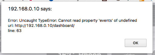

When I use calendars.combined I get this error message:
Error combined calendars
Screen Shot 2017-05-12 at 11.03.48.png (34.22 KiB) Viewed 2204 times
Looks like this happens with the private calendar. So, when I got back from work, I will see if I can find out WHY.
