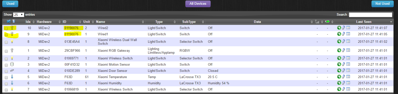

Post by levynger »
corbin wrote:
levynger wrote:@corbin, @deennoo found a problem for the ctrl_neutral1 - it wont be triggered as the message is hardcoded for ctrl_neural2 only..
Can you check my latest github update hasn't broken the new switch commands you added?
I'm not sure how best to solve the ctrl_neutral/1ctrl_neutral2 problem. I faced something similar with the gateway colour and brightness, where I didn't want to query the database each time for the values needed - ended up using local variables. This approach for the switches would need to store the switch type/name for each switch, and would need an array or similar.
i will check later on today on my ubuntu and update..
regardin the ctrl# device, though perhaps to add to the ID of the device something like hex identification for "ctrl2" and "ctrl1"
before sending command from the UI and before comaring it in the Reciever proc , remove it.. this way i can determine which ctrl and assign the correct command to it, and avoiding extra sql queries on each command transmitted.. sounds ok? or i am missing something?
levynger
Posts: 87
Joined: Wednesday 21 December 2016 19:03
Location: Israel
Post by levynger »
@corbin,

levynger
Posts: 87
Location: Israel
Post by levynger »
corbin wrote:I've undone my change so should compile again. I'll try to get it going in Linux later.
Works fine! thanks.
Dual switch also seems to be fine..

levynger
Posts: 87
Location: Israel
Post by levynger »
corbin wrote:
levynger wrote: i will check later on today on my ubuntu and update..
I don't think this will work as the id is passed in externally in the WriteToHardware function.
I though removing it before sending to HW again..
i eventually added array as you suggested to store all IDs belong to the ctrl2 (for multiple ctrl2 devices as home), and added an optional paremeter to InsertUpdateSwitch to identify the ctrl2 device from the UDP reciever.
also tried now to change its type to On/Off, and it it twice with Unit field.. however seems that domoticz wont allow to use same ID for the same Type..
the same one is being updated..
so i guess will remain with Selector for the Aqara..
work in progress.. takes time.. at least to my c++ skills.. :D
UPDATE: found how to make 2 on/off type for the same HW.. had to change the xcmd.unitnumber before providing it to mainworker!
