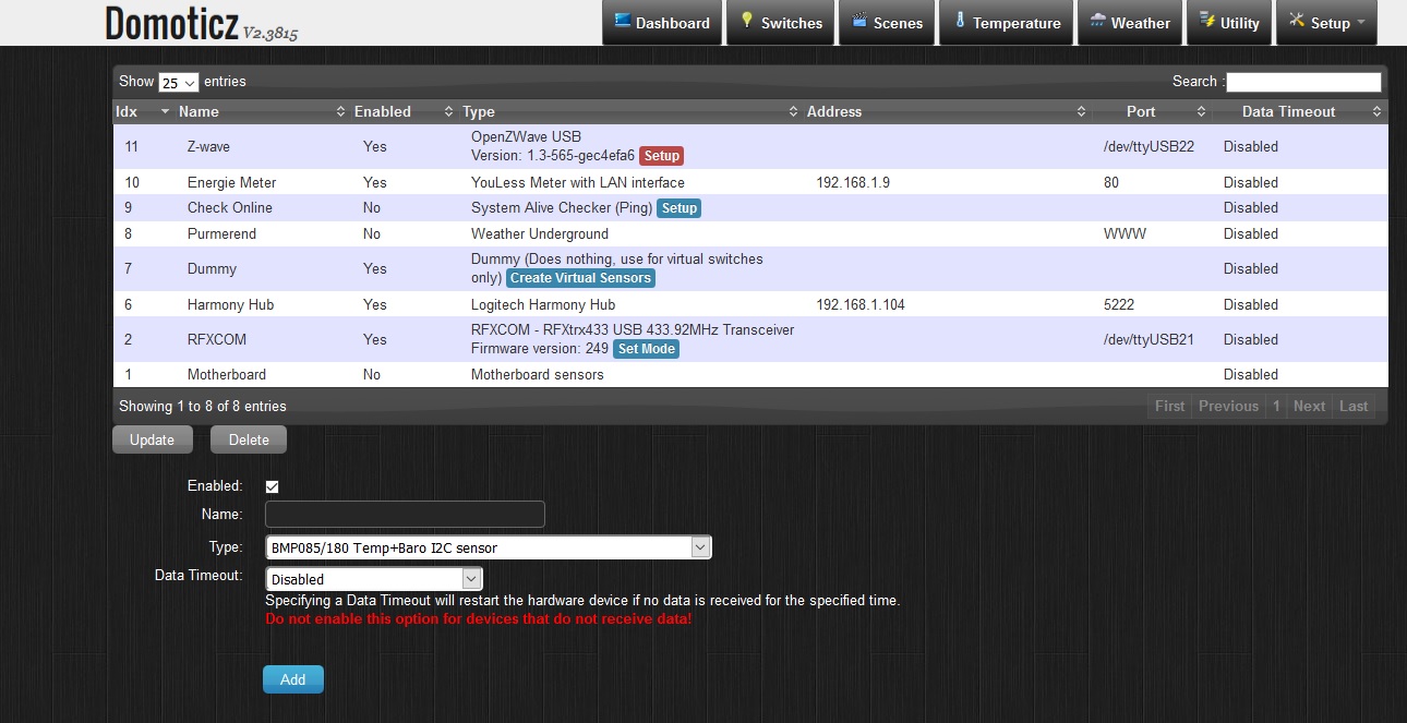

I have a very weird issue with the domoticz package for the Syno.
I have a syno DS411+II and can install the package without issues. Package starts and you can select hardware and change settings etc.
BUT........ When i restore a database using the settings page then I cannot use the package anymore.
All the hardware options are gone, only blanc empty line, the settings are messed up , language Arabic etc instead of english.
When the database is restored the first time it all looks fine the sensors and switches are visible and hardware is visible.
But the minute you click on something to change it all is gone and messed up.
Any ideas how this can be? The backup of the database comes from a RPI2 with domoticz version V2.3799 Build Hash: 70987e6
So restoring a working DB messes everything up
Here are some screen to make things more clear and hopefully a solution is out there
- hardware screen just after restoring the database
- Domoticz_Syno411+II-hwscreenjustafterDBrestore.jpg (215.49 KiB) Viewed 3967 times
- settingsscreen just after installation of the package. All looks fine
- Domoticz_Syno411+II-Settingsscreen.jpg (245.81 KiB) Viewed 3967 times
- Just installed the package and hardware is visible and selectable
- Domoticz_Syno411+II-HWscreen.jpg (204.35 KiB) Viewed 3967 times

I don't have a solution, but can add to this issue that I too have a strange restore problem; I tried to import a backup from my Windows test DOmoticz enviroment to my Synology setup... and discovered that the backup from the Windows system was 0 bytes.
