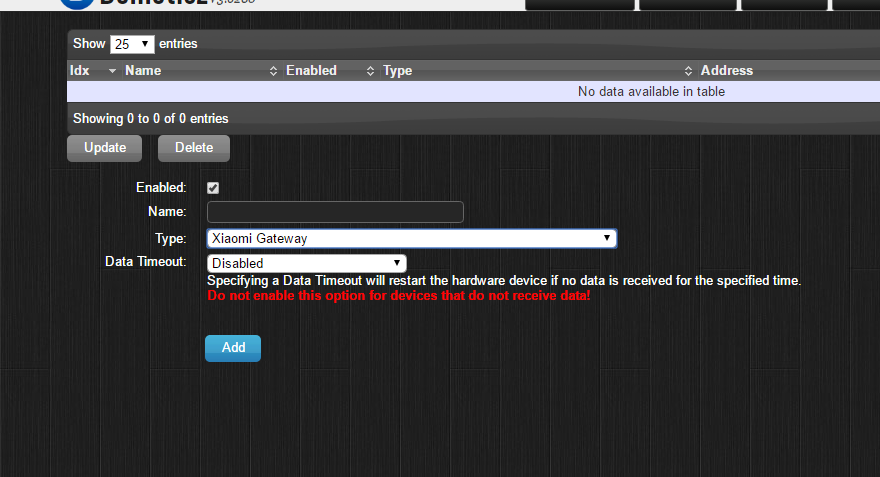

Corbin, I finally assembled Visual studio with domoticz,and cloned your github.
when i run domoitcz, im missing the gateway ip and passoword fields, resulting in empty strings in m_gatewayIp and m_GatewayPassword
any idea what can cause this?

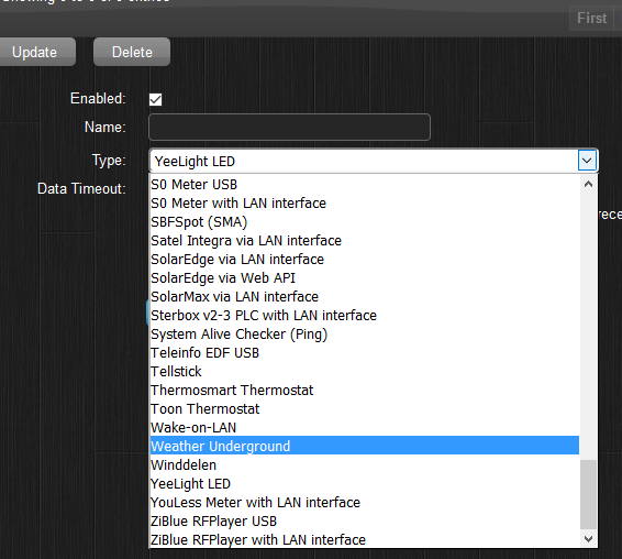

any idea of my "problem"? I can't even see xiaomi gateway in "type" of hardware.

@levynger, @psedma, clear your browser cache so that you get the fresh files.
levynger
Posts: 87
Joined: Wednesday 21 December 2016 19:03
Location: Israel
Post by levynger »
corbin wrote:@levynger, @psedma, clear your browser cache so that you get the fresh files.
Thanks @corbin
וtried that, also using the chrome plug in you suggested.
I r happen only on the compiled version from visual Studio.
On my Ubuntu, I pulled and compiled.. No issues.
corbin
Posts: 463
Location: Brisbane, Australia
Post by corbin »
copy the whole 'www' folder from the root of the project to the msbuild folder, replacing what is already there.

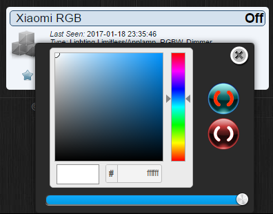

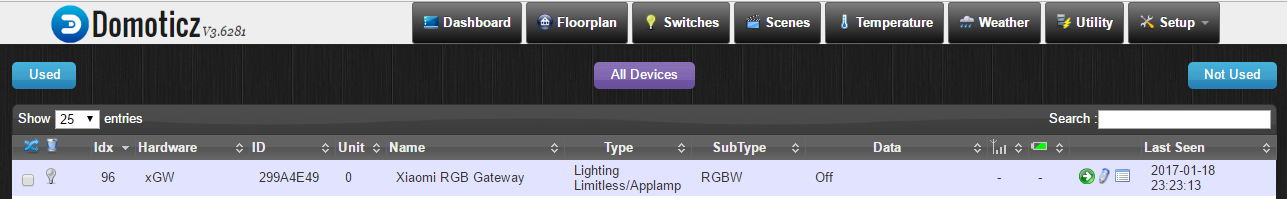

corbin wrote:
vetalok wrote: Emm... When I enable LED from MiHome - Domoticz off light
I've made a couple of changes, you will now need to turn the light on from the app to get it to detect in Domoticz, and I've added some extra log output. Can you try that and post the output if it still isn't working?
XiaomiGateway: unhandled model: gateway
{"cmd":"report","model":"gateway","sid":"f0b4299a4e49","short_id":0,"data":"{\"rgb\":1694498782}"}
{"cmd":"report","model":"gateway","sid":"f0b4299a4e49","short_id":0,"data":"{\"rgb\":0}"}
update: after git pull from https://github.com/corbinmunce/domoticz
XiaomiGateway: rgb received value: 1694498782
XiaomiGateway: setting on to true
XiaomiGateway: New Gateway Found (299a4e49/Xiaomi RGB Gateway)
2017-01-18 23:23:09.751  (xGW) Lighting Limitless/Applamp (Unknown)
XiaomiGateway: rgb received value: 0
XiaomiGateway: setting on to false
XiaomiGateway: Updating existing - nodeid: f0b4299a4e49
2017-01-18 23:23:13.744  (xGW) Lighting Limitless/Applamp (Xiaomi RGB Gateway)
and as a result:
