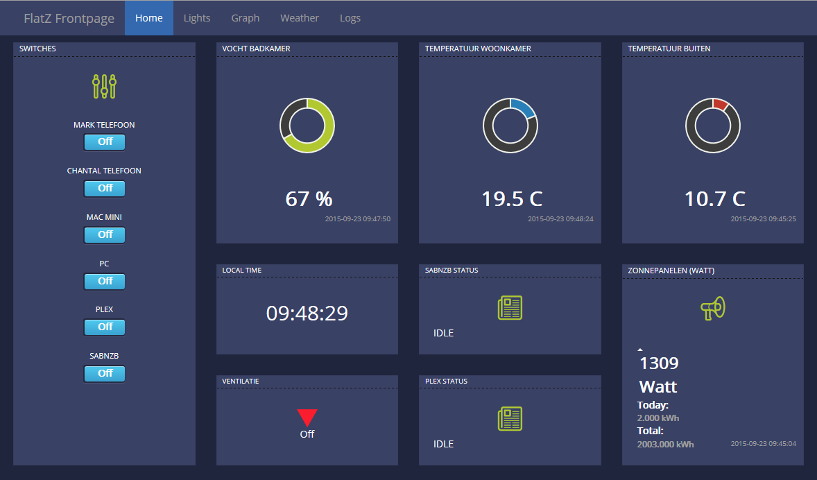

https://github.com/galadril/FlatZ-Frontpage

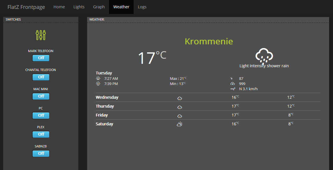

I'm adding a weather tab

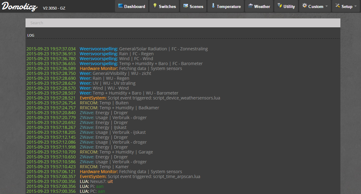

Is it also possible to append the log? That would make the filter option really great.

Oh, and great work on the weather tab. Are you using the Skycons ? Or are those static images ?

Used your log and changed it a bit and am now using it as my Domoticz log (as a Custom page). The search function is also very handy and I like it that the newest item shows on top.
