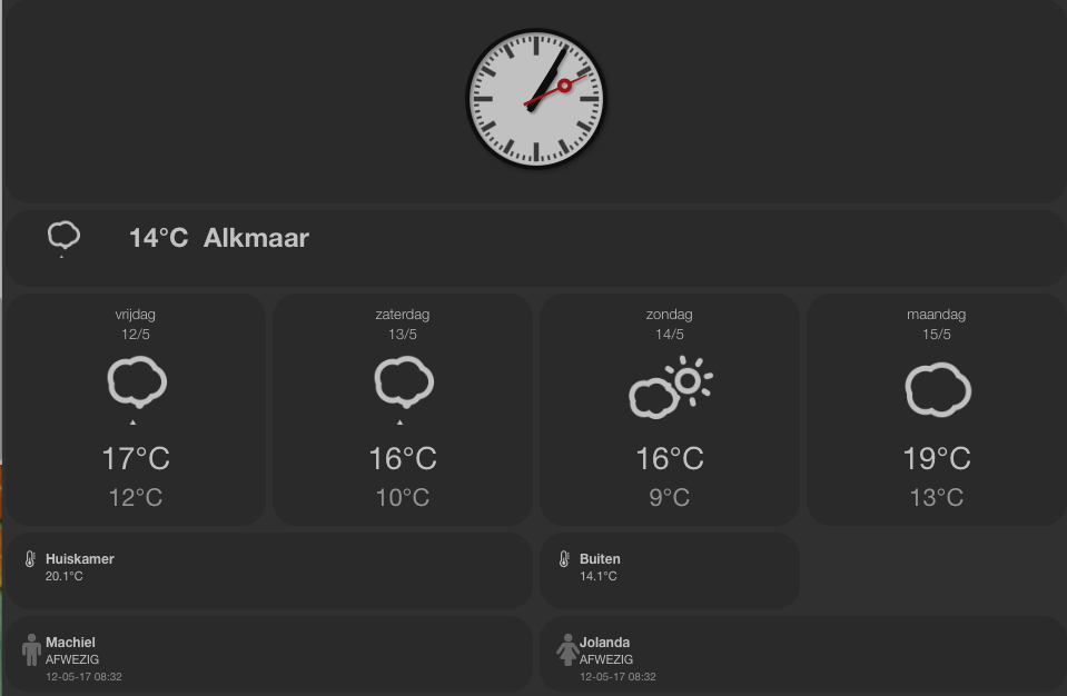

This is my standby screen.
Is it possible to center the text in the lower blocks, is this something I can do?
