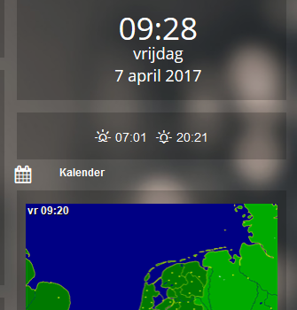

I send you a pm with a screenshot but i think the screenshot isn't send with it so here the screenshot.

I'm filling in my dashboard and i noticed that a block with a scene in my case never gets bigger than 4 even if i fill in 12.
Is this correct and that works only with dimmers?
It also don't work if i do idx_3.
Edit: Also the calendar button isn't displaying correct.
Sorry i have the time. Had surgery and sitting at home 8-)

SwordFish wrote:I'm filling in my dashboard and i noticed that a block with a scene in my case never gets bigger than 4 even if i fill in 12.
I tried this, for my scene with idx 3, and it works:
var blocks = {}
blocks['s3'] = {}
blocks['s3']['width'] = 12;
var columns = {}
columns[1] = {}
columns[1]['blocks'] = ['blocktitle_1','s1','s3',233,62]
columns[1]['width'] = 5;
Whats wrong with the calendar button?
Edit: Sorry, i see your screenshot now ;)

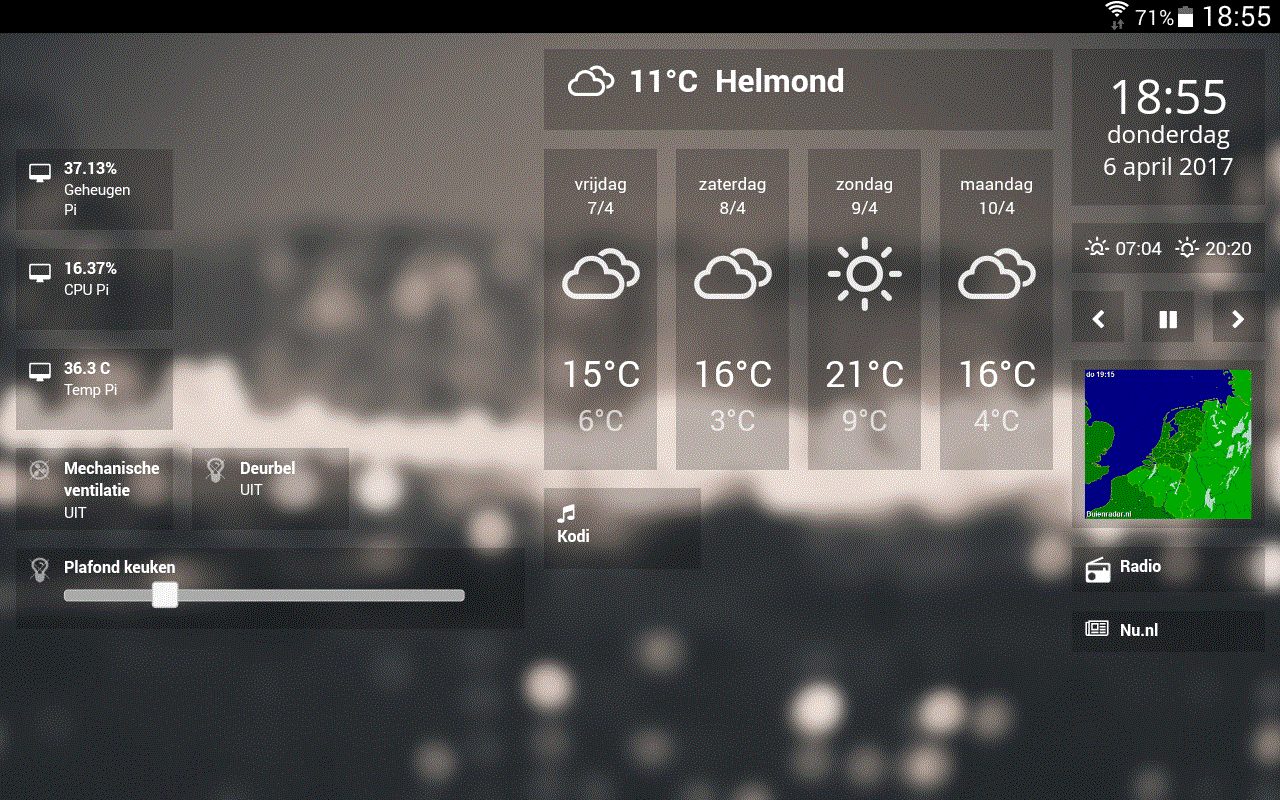

Preview with multiple dashboards:
