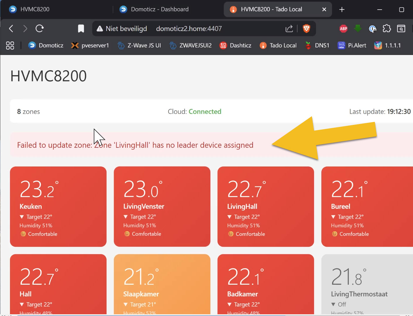

Got this far like last time... still same error:
Tado App update works and gets updates in Tado-Local
Other way : change temperature fails... no leader device
I did update : git pull.... several file replaced... rebooted
See attached
See attached
- 2025-11-14_19-19-54.jpg (191.89 KiB) Viewed 95242 times

Re: Tado Local and python plugin
<iP>:4407/zones gives:
"homes": [
"id": xxxxxxx,
"name": "HxMx8x0x"
"zones": [
"zone_id": 1,
"name": "Keuken",
"uuid": "filled in repladed by me",
"leader_device_id": null,
"leader_serial": null,
"leader_type": null,
"is_circuit_driver": false,
"order_id": 0,
"device_count": 1,
"state": {
"cur_temp_c": 23.5,
"cur_temp_f": 74.3,
"hum_perc": 51,
"target_temp_c": 22,
"target_temp_f": 71.6,
"mode": 1,
"cur_heating": 0
"home_id": xxxxxxx
"count": 8
"homes": [
"id": xxxxxxx,
"name": "HxMx8x0x"
"zones": [
"zone_id": 1,
"name": "Keuken",
"order_id": 0,
"device_count": 1,
"state": {
"cur_temp_c": 23.5,
"cur_temp_f": 74.3,
"hum_perc": 51,
"mode": 1,
"cur_heating": 0
"home_id": xxxxxxx
"count": 8
Kind regards,
Sloeber70
Linux Debian 13 standard edition
Domoticz latest beta on ProxmoxVE Virtual Machine
Sloeber70

I also got the no leader device when updating a setpoint.
