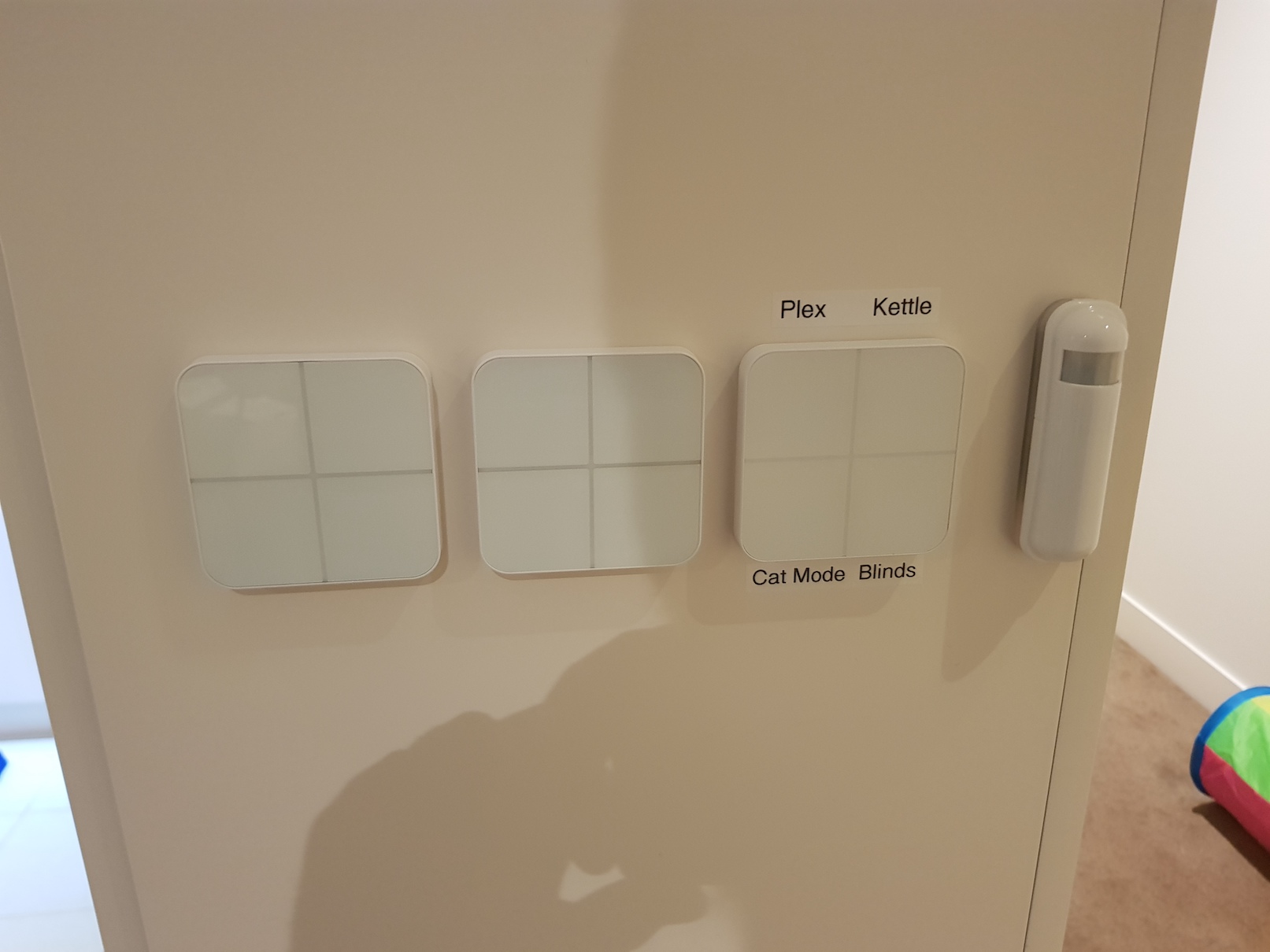

Very exciting! Three Wallmotes serve as the kitchen / living room control center.
In the morning I can do everything from raising the blinds to boiling the kettle and playing a favourite internet radio station. 8-)

Hi Guys,
Great product and good build quality, have these doing my whole house!
Only issue i have is making domoticz do a simple on/off switch or dimming. The only way i have been able to make this function correctly is through group associations direct with other devices. works great. But, i have some scenes made in domoticz that i want to turn on/off. Problem i find is domoticz only recognizes the ON command and the button will stay ON. press the button again and it still stays ON. I cant find a way to do a simple flip/flop with on/off.
I have tried a Blockly with a When button ON, switch OFF after 5 secs. but this just makes the scene i have attached turn ON then OFF after 5 secs.
Any advice is much appreciated.
