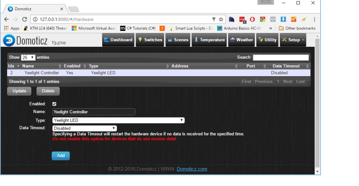

Any Windows Domoticz users want to test my Yeelight code?
corbin
Posts: 463
Location: Brisbane, Australia
Re: Help with Yeelight Bulb
Post by corbin »

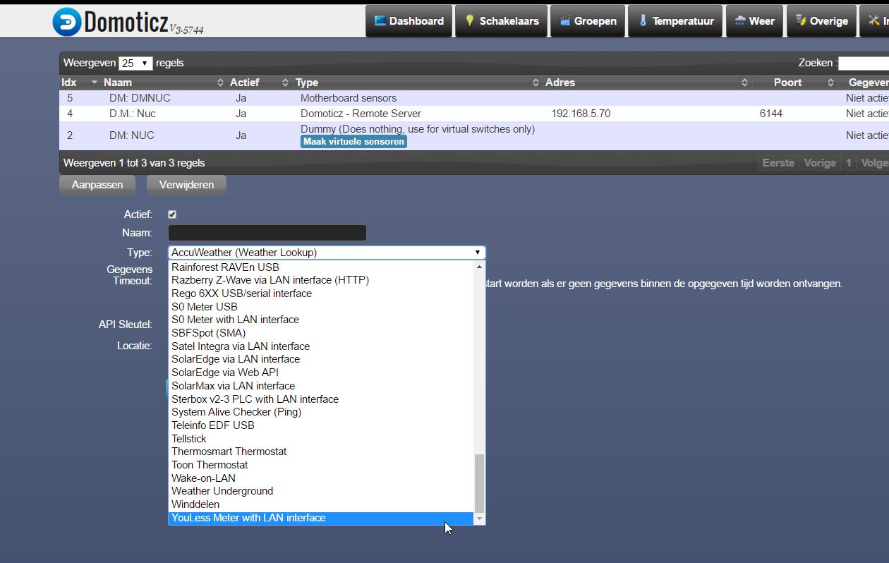

Did install the last Windows Beta, on my NUC
No Yeelight?
corbin
Posts: 463
Post by corbin »
Derik wrote:Did install the last Windows Beta, on my NUC
No Yeelight?
Derik, try this link - compiled for Windows. https://1drv.ms/f/s!AiVyh7yRnMKPgT1s4nzWDgJX7UaO
The code on github probably isn't working right now - I am rewriting it to work in Linux.
Derik
Posts: 1605
Post by Derik »
No Yeelight?
Did install this version on my pc.
Ad the yeelight..
Only see no thing happend?
While my light is on and visible in my lan.
What do i need to do more?

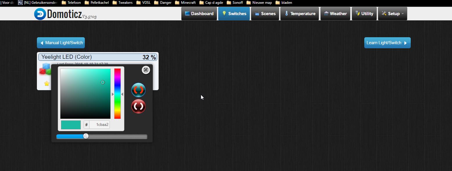

Derik
Posts: 1605
Post by Derik »
Got him :-)
