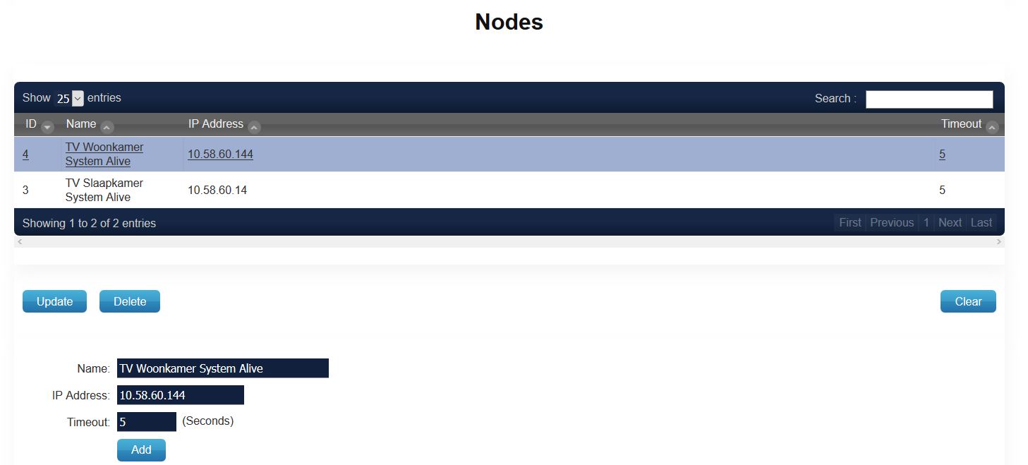

Can you help me? Need more details to point 7. I don't know how add switch to System Alive Checker without ip address.

I do not understand your question. You can't have a System Alive Checker without an IP address. See below

7. Make the system alive checker sub/slave device (wk.tv.local system alive) of the TV Woonkamer switch.

Re: Step by step guide: switch on and off tv via cec
Regarding stap 7
See attached, add the alive checker device in the properties screen of the main TV switch, created in step 4
Thanks mate. Works but bad, my Philips 7er is ...
