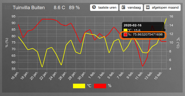

While I was using Dashticz and checked some graphs I noticed a little odd behavior. It seems that the tooltips parameter shows a large amount of digits behind the decimal separator for last month. It works well for all other measurements like Today and Last Hours but the last day of this month however...
Last month - today:
Last month - *not* today:
Refreshing/re-selecting makes no difference.

That's is the standard tooltips, not the new tooltips. Can you check your block config?
Sjonnie2017
Posts: 365
Joined: Wednesday 02 August 2017 19:43
Domoticz version: Latest ß
Re: Multiple sources in one graph
Post by Sjonnie2017 »
Sorry! You're right of course. :oops: Added the new tooltip parameter to the blocks and all is working as expected now.

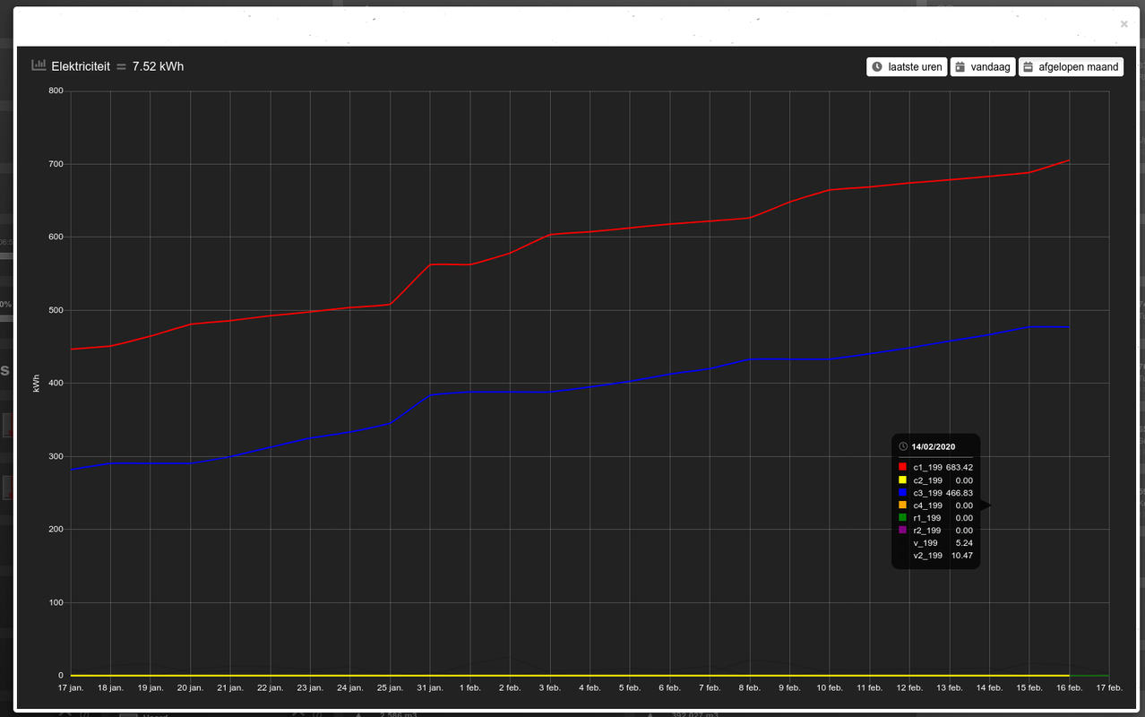

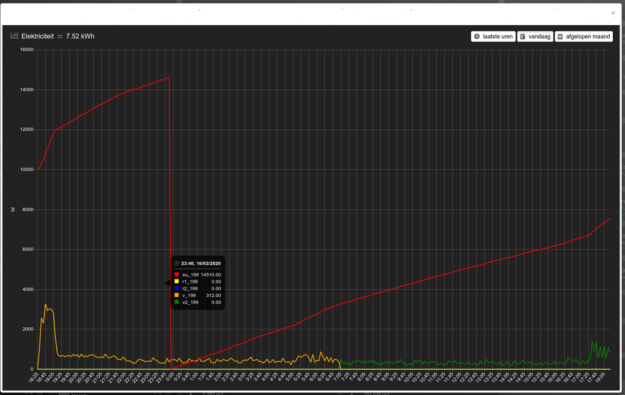

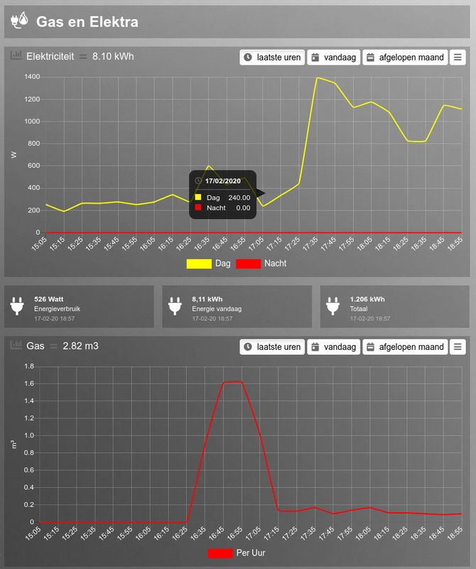

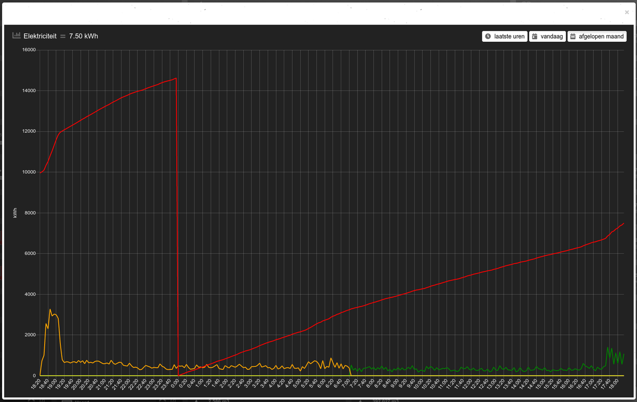

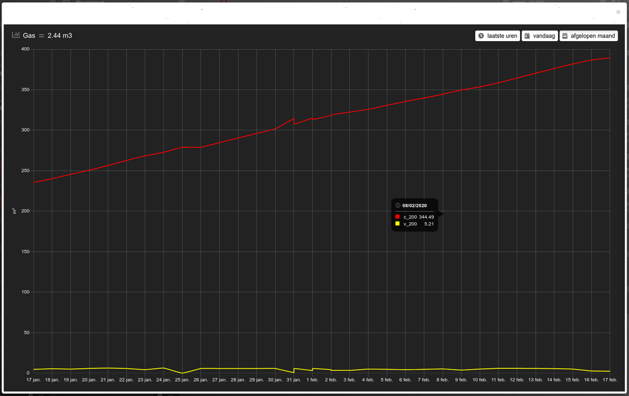

The pictures:
No tool tips on popup gas:
Dashboard graphs on first load:
Popup electricity on first load:
Popup electricity Last Month after first load:
Popup electricity Today after selecting Last Month:
Popup electricity Last Hours after selecting Today
I am almost certain it won't help a bit but I have added the debug code for the electricity graph just to be sure:
