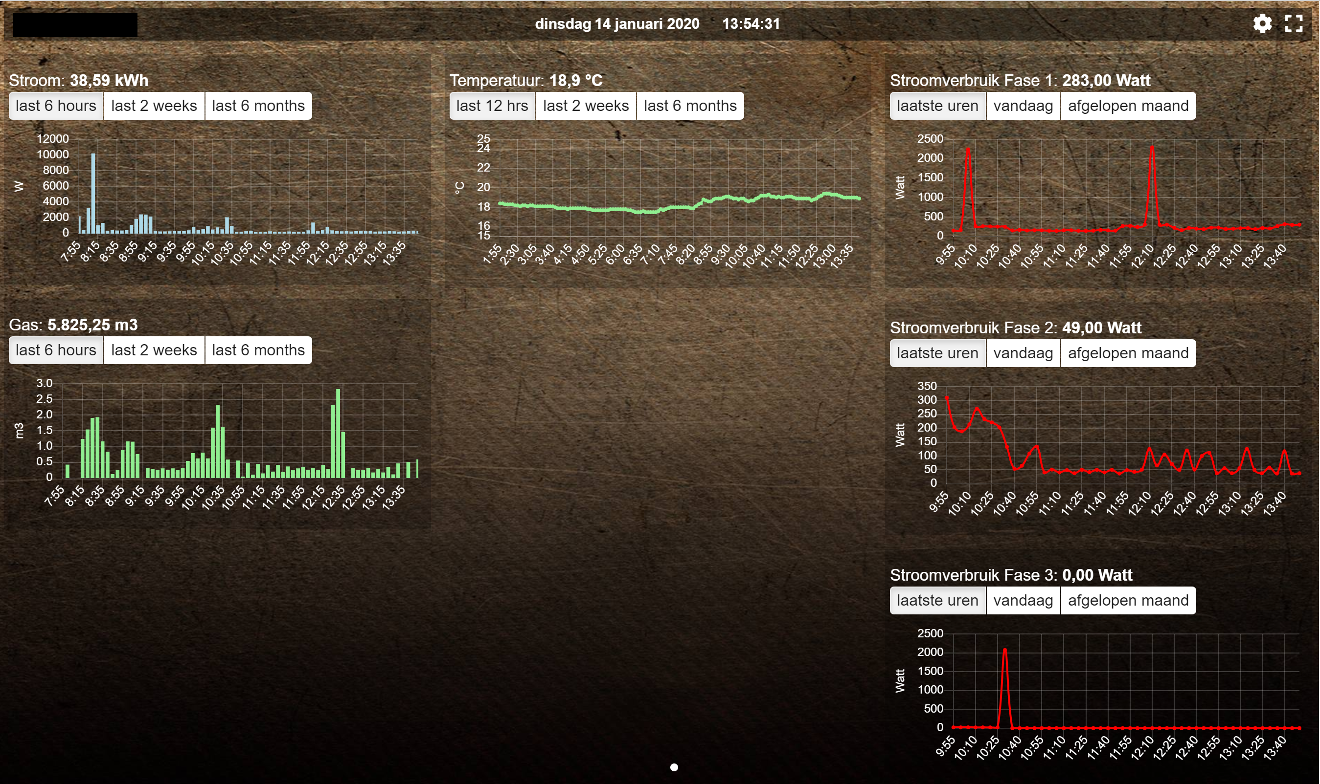

I recently started using Dashticz and really like how easy it is to create a nice dashboard for Domoticz. I do have one question:
I have a temperature sensor in my thermostat and in my Hue motion sensor somewhere else in my home. By adding two graphs I can show the output of the two devices in different graphs.
However I would like to combine these outputs into one graph, consuming less space on my dashboard. Unfortunately so far I am unable to do so, since these are two different devices and I cannot find how to combine these into one graph.
Is it possible to show the output of two devices in one graph? And if so, how can I do that?
Thanks a lot for the help!

Would also be great to be able to add more than two devices. I would like to display:
- the usage of all three phases of my P1 meter in one graph
- the temperature of my thermostat, the outside temperature and the temperature of a Hue motion sensor elsewhere in my house into one graph

Currently I am monitoring my floorheating (to tune it) by using 6 temperature sensors: supply, return and 4 strings. Therefore, yes, count me in for a multiple sources graph. I now have to go to Excel to better view the relation between the 6 measuring points.
Another swipe on my Dashticz tablet to a summarizing graph would be very nice. Count me in!

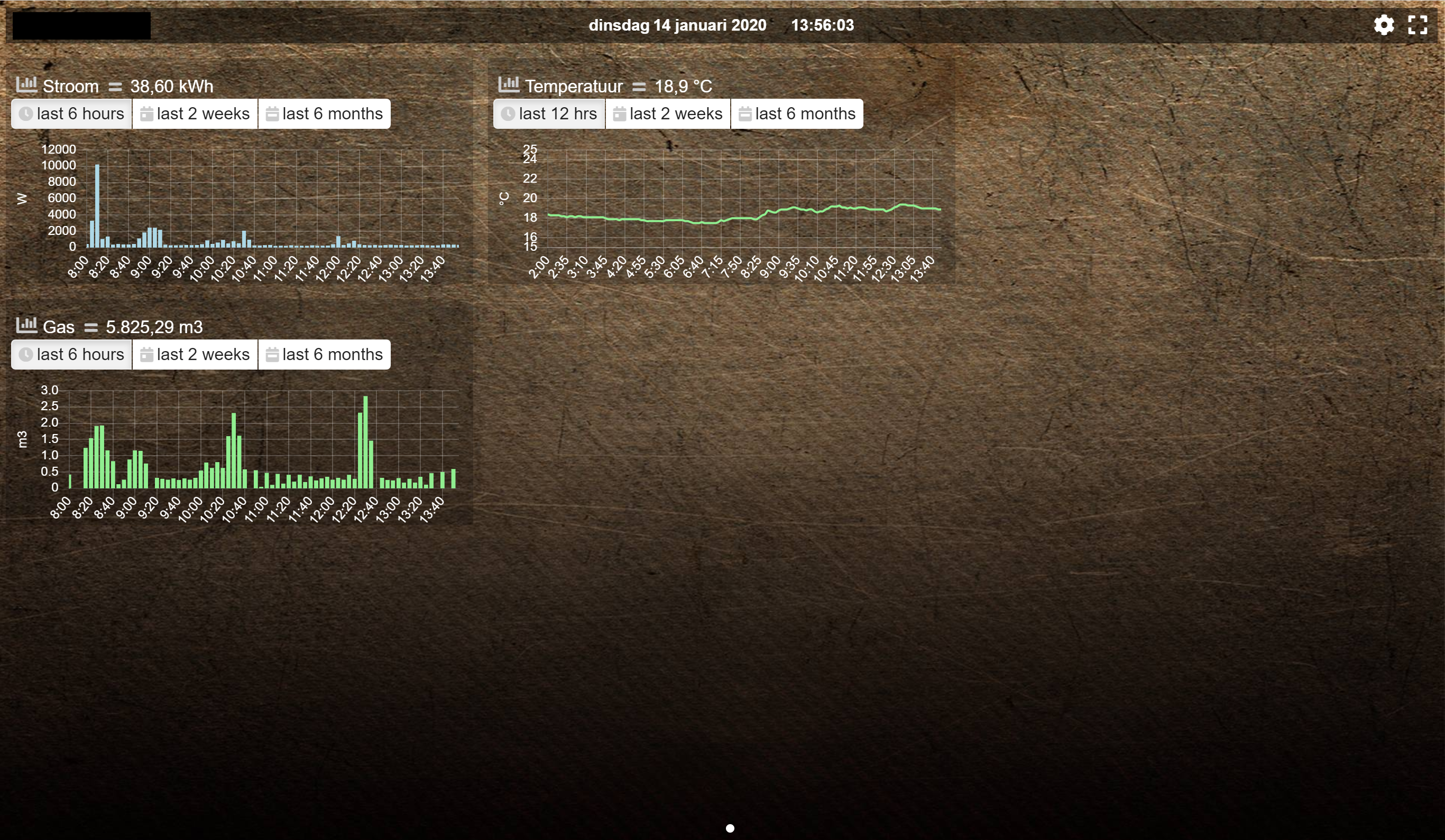

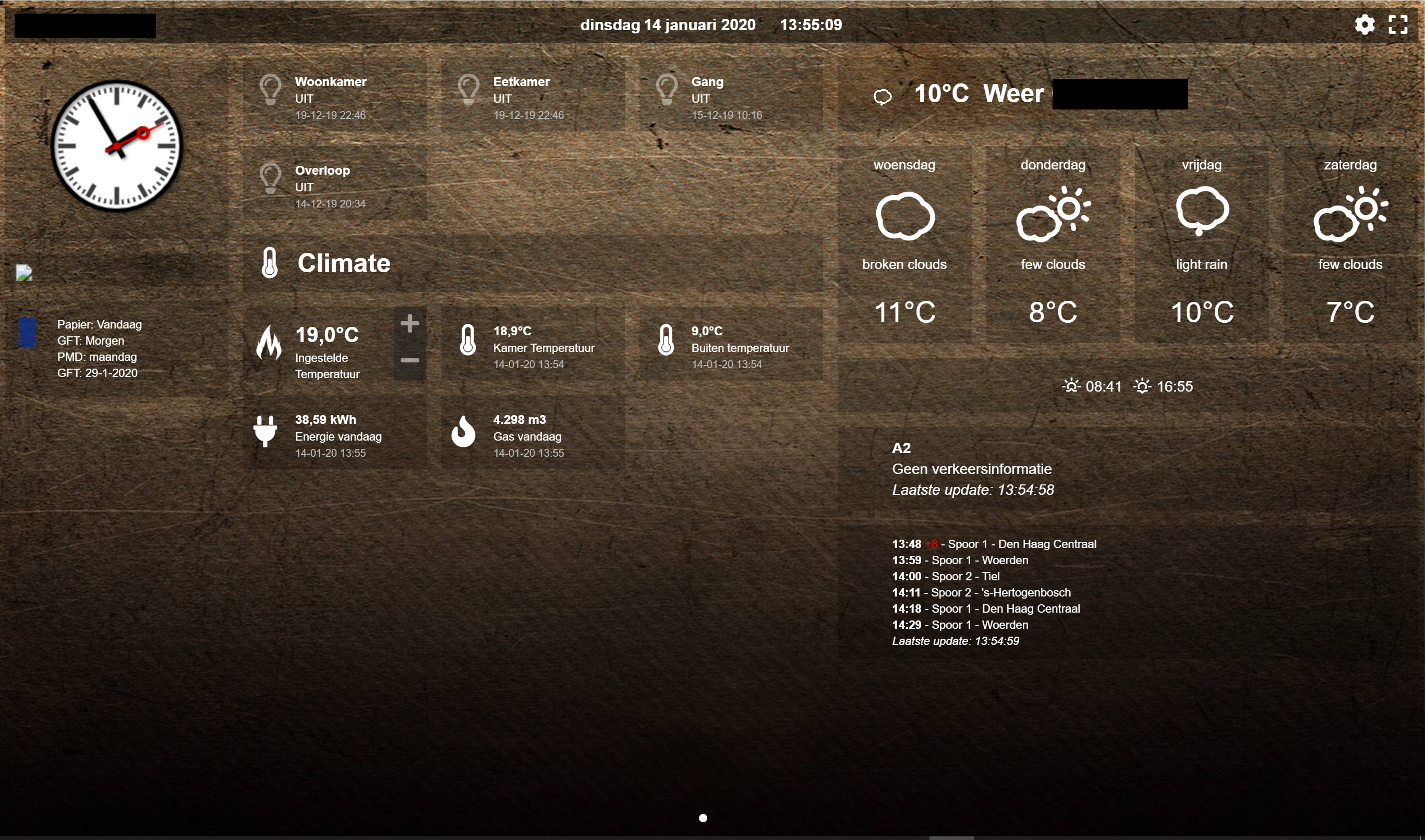

Just took the files from the multigraph branch and copied my config.js from my main folder. When I opened the dashticz dashboard, three of my graphs disappeared.
When I added a multigraph section (just the block, not added the config to a column), the dashboard broke down:
I added this block.
Working page 1:
Working page 2:
Page 2 with new version (three graphs to the right gone)
Page 1 after adding above multigraph section (page 2 gone and a lot of controls jammed onto page 1)
- my two page dashboard became just one page
- all my graphs were gone
- the left column only showed sliders for each of my Hue lights
I added this block.

Working page 2:
