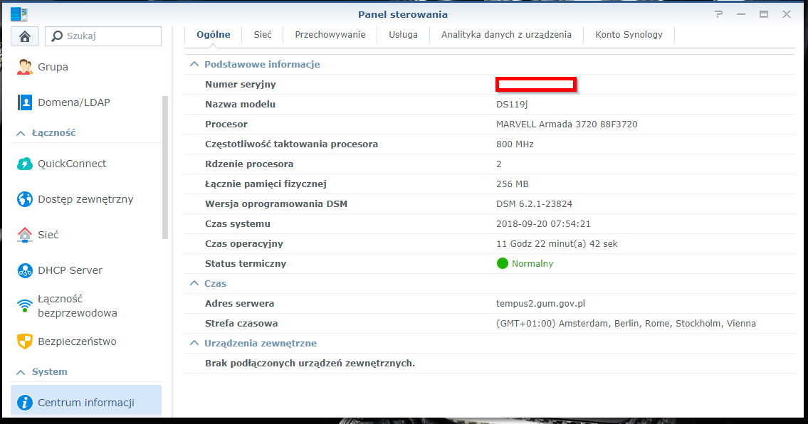

Please help!
I have DS119J, unit is not available yet.
I can't install domoticz
Please prepare proper version for this model

DS119j use arch-armada37xx and I will build a beta version for you to test.michass wrote: Thursday 20 September 2018 7:58 Please help!
I can't install domoticz![]()
You can download from my server
Here: http://www.jadahl.com/domoticz_beta_6.2/

jumbotroll wrote: Thursday 20 September 2018 10:40DS119j use arch-armada37xx and I will build a beta version for you to test.michass wrote: Thursday 20 September 2018 7:58 Please help!
You can download from my server![]()
Working:D
Can you prepare stable?

Still the same.jumbotroll wrote: Monday 24 September 2018 23:44 Take backup of domoticz.db and try to reinstall domoticz package, maybe something went wrong under update DSM or latest domoticz..
I think DS119J have better CPU, same RAM, but have limitations.
On DS115J everything works. maybe not fast but works. They want, to buy more expensive models.
Synology NAS
