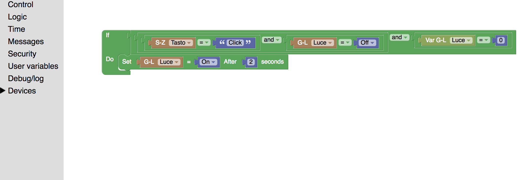

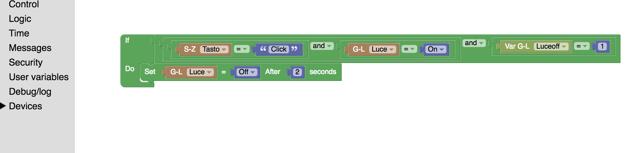

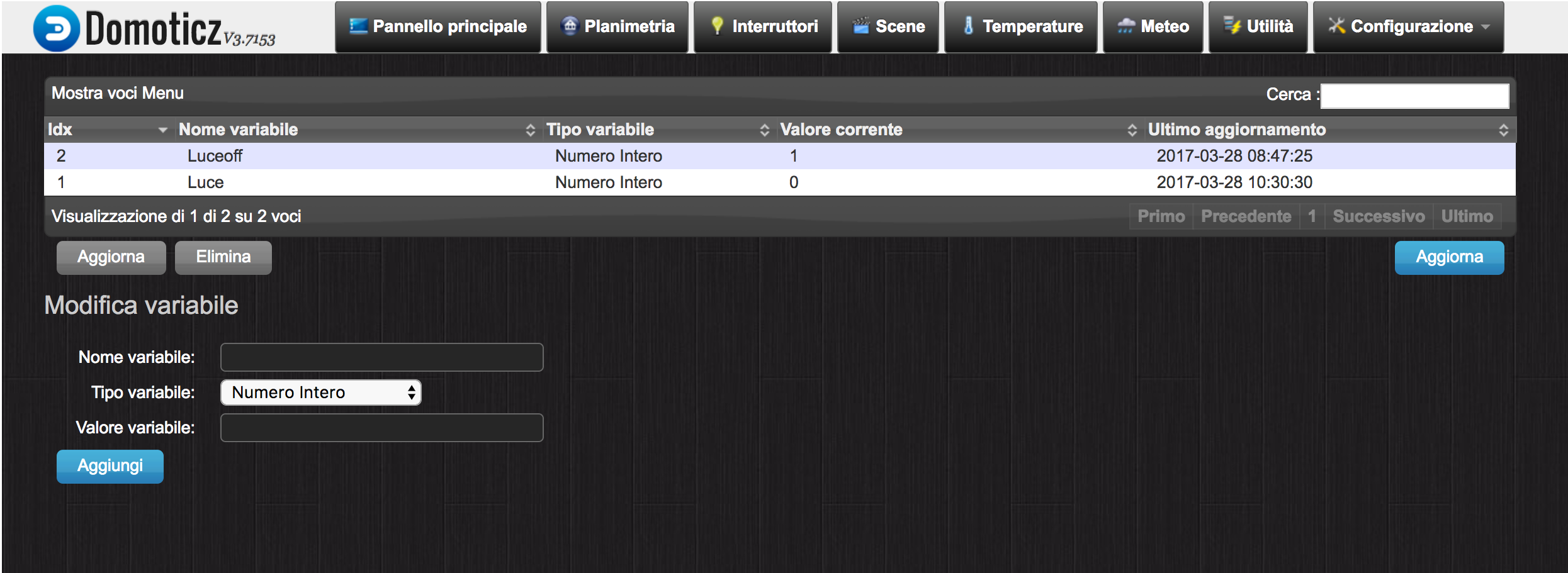

marcotrumpet wrote:Does anybody know how to write a lua script to turn on/off lights like the mihome app does?
+1
It seems I did it.
I made 2 variables (the one in this image, sorry but I'm italian)
variables
variables
Than I set the delay off of the switch at 1 sec.
The blocky event for "click --> light on" and "click at the same wireless switch --> light off" looks like this
I try it whit 2 dummy switch, I'll try as soon as possibly with the real one.

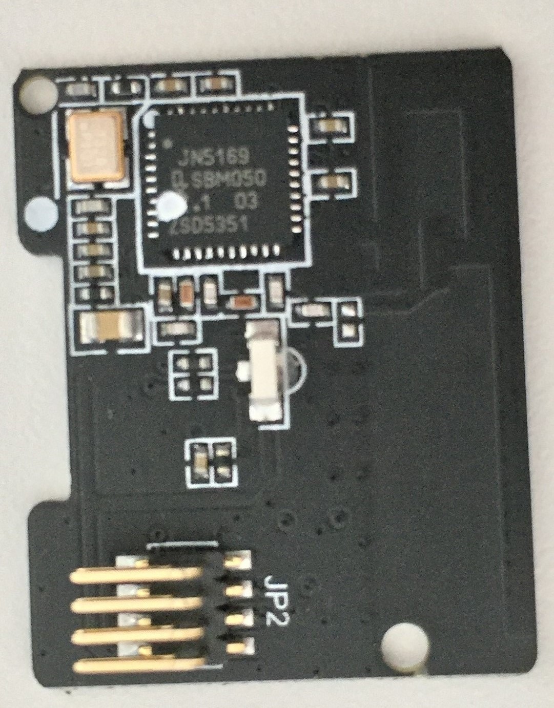

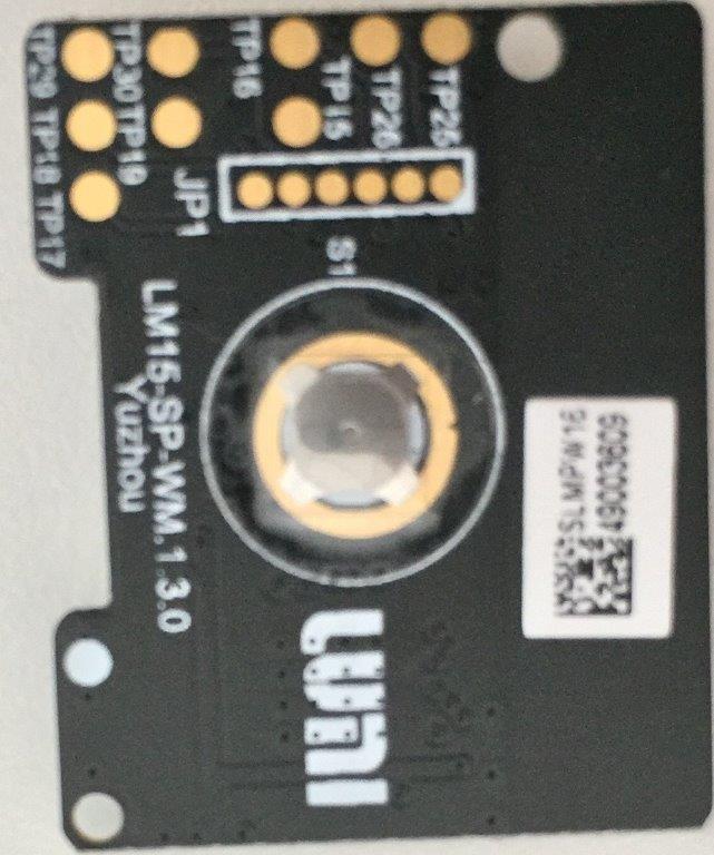

I read only the half of the full post sorry ... But i want to share my worries on the plug !
As I find that plugs are dangerous with an adapter I easely opened 3 of them and replaced pin with cable and trying to directly integrated in the outlet box in the wall. But range of mi plugs are a nightmare, out of there casing and specially when a charge on the ouptut
So did someone figure out the range or open plugs to integrate it ?
I taken some pics of the network board in the plug who can easely be moved from one plug to another keeping the association, also we can see a classic zigbee component http://www.nxp.com/documents/data_sheet/JN5169.pdf so plug should work as a repeter
