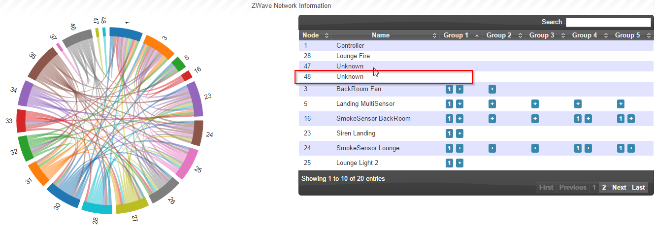

Had nothing but trouble with this and finally saw your post above.
Tried it and managed to add the node, but step 3 can't be done, as the Group 1 section for that node is blank:
2016-04-13 15_53_22-Domoticz.png (176.19 KiB) Viewed 4924 times
Richie

That does not look good. Good you exclude/include again ?
How does the node table look ? Does it recognize that it is from the Manufacturer NodeOn ?

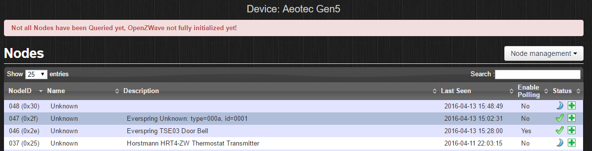

Thanks for that.
Did you have to do something prior to adding the node (some people have had to edit config files i believe)?
As you can see from my screenshot it is not recognising the device:
2016-04-13 16_27_11-Domoticz.png (60.35 KiB) Viewed 4915 times

gizmocuz
Posts: 3072
Location: Top of the world
Re: Nodon Soft Remote crc 360x
Post by gizmocuz »
No, i updated domoticz to the latest version #5060+
gizmocuz
Posts: 3072
Post by gizmocuz »
Make sure you see node in the table like in the image under point #2
