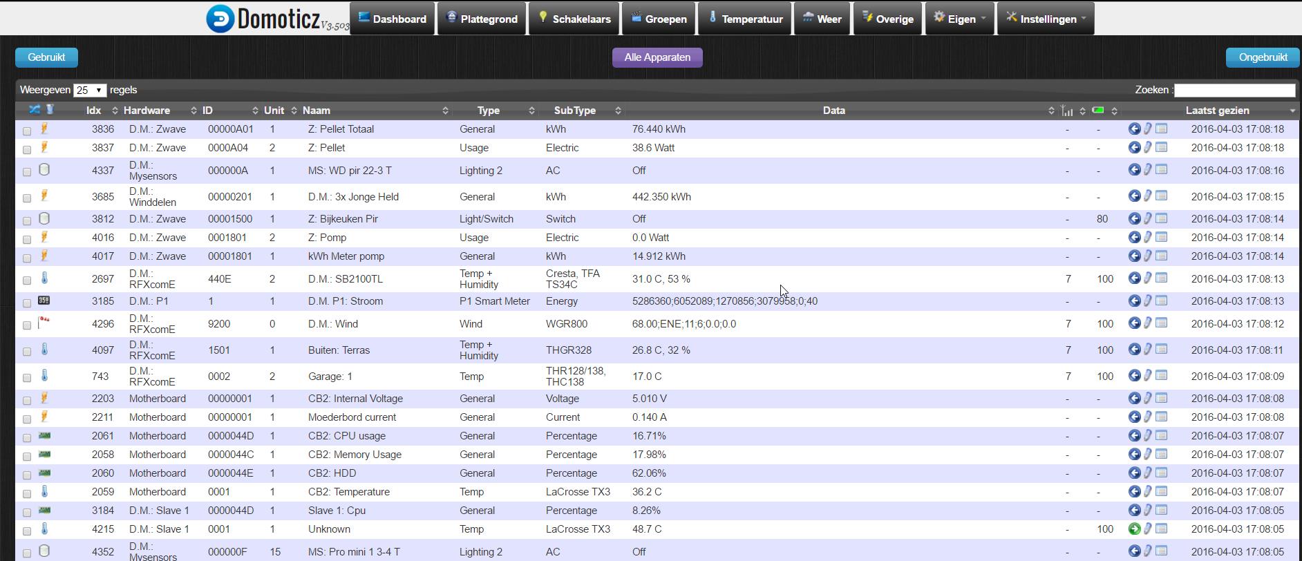

Re: KAKU specs
yes they are...
All the switches are here visible when they are green new, other bleu

Re: KAKU specs
Excellent. I had not seen that in the large list of devices. I guess some of my neighbours own weather stations...
Next question is how I can see what KAKU address was used? I can see a few switches of subtype ARC, but no address.

Re: KAKU specs
Got it. I need to learn to read a bit more before drawing conclusions.
The number under the header "ID" is the hexadecimal representation of the KAKU home address.
A simple ASCII table helps to understand.
The value under "unit" is the device address.
In my case: ID 45 Unit 4 is KAKU E4.
