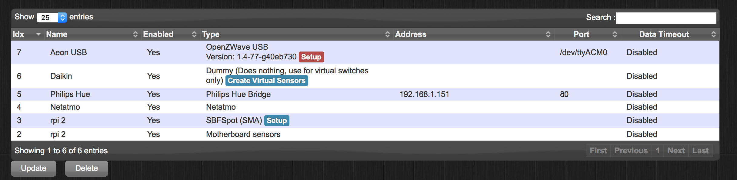

I installed an Aeon USB Stick Gen 5 on the raspberry pi 2, after having linked it to the Stick the Fibaro motion sensor. Domoticz firstly saw both the Aeon and Fibaro devices within the Aeon Stick setup page, but couldn't see the parameters (light, temperature and so) related to Fibaro device on devices page. After a domoticz upgrade the setup button on domoticz is red and the device setup page is empty I did stop and started again domoticz without solving this issue.

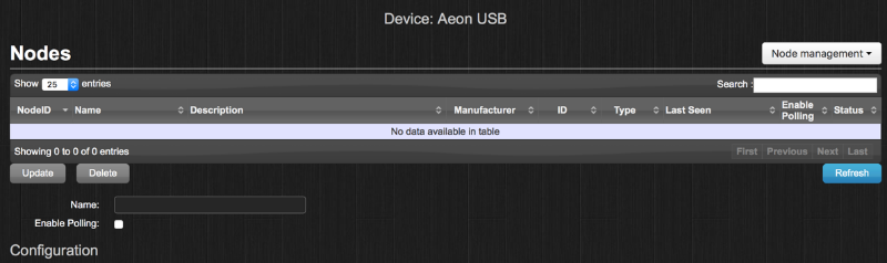

Re: cannot see z-wave devices

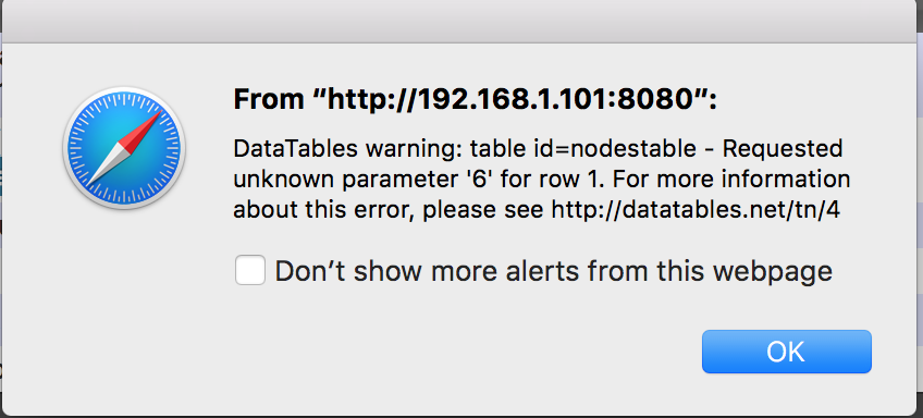

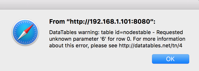

very strange, I rebooted the rpi (after system update) and now setup button in blue.
When I click on the setup button two pop-ups appear:

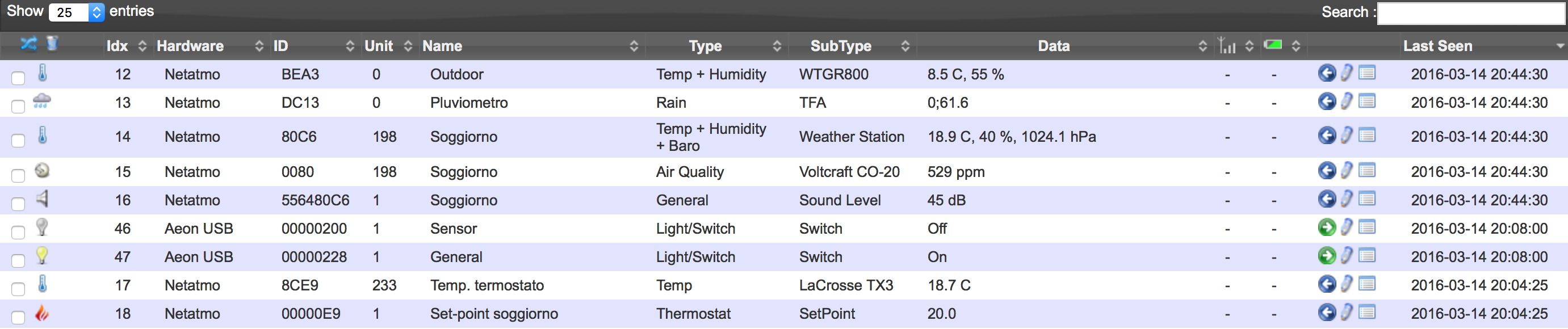

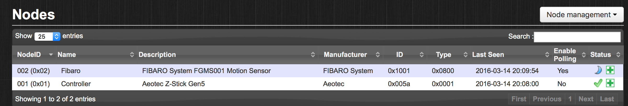

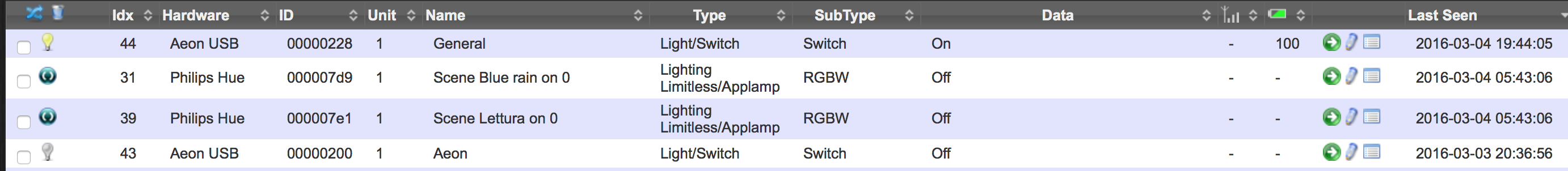

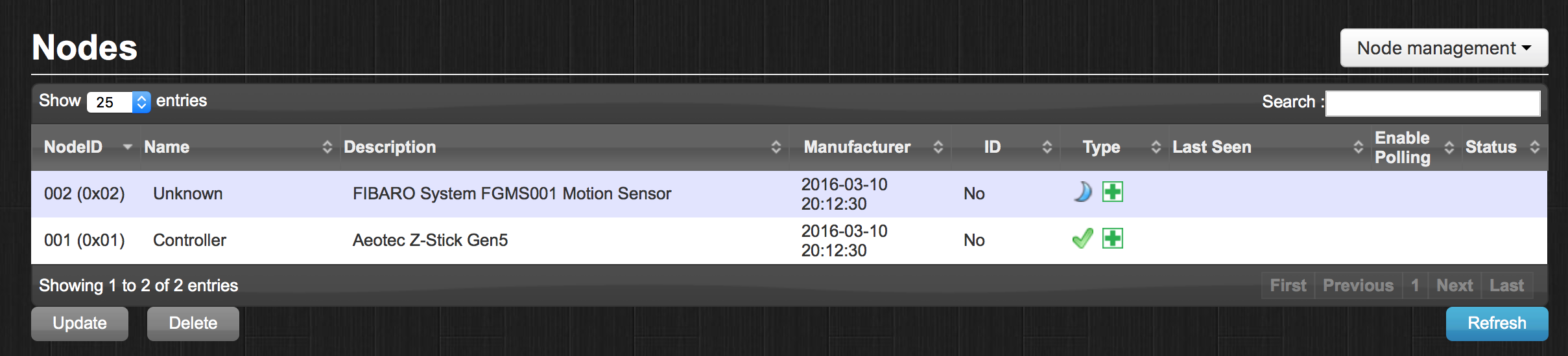

then I see the devices in the Aeon setup page:
but couldn't see the Fibaro on the devices domoticz page. I see only two switches related to Aeon Stick
- StephaneG
- Posts: 19
- Joined: Tuesday 17 November 2015 10:10
- Location: France
Devices 43 and 44 are your fibaro's sensors (their ID's are 000002xxx, and 2 is the fibaro's node number).

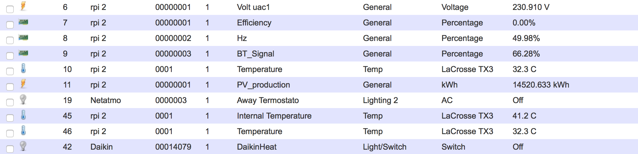

why fibaro sensor appear as two switches when it is a there-in-one sensor (motion, temperature and light)?
what should I do (apart click on green arrow)?
I also see some strange devices related to rpi2, could be from Fibaro sensor? thanks
gabriele
gabriele

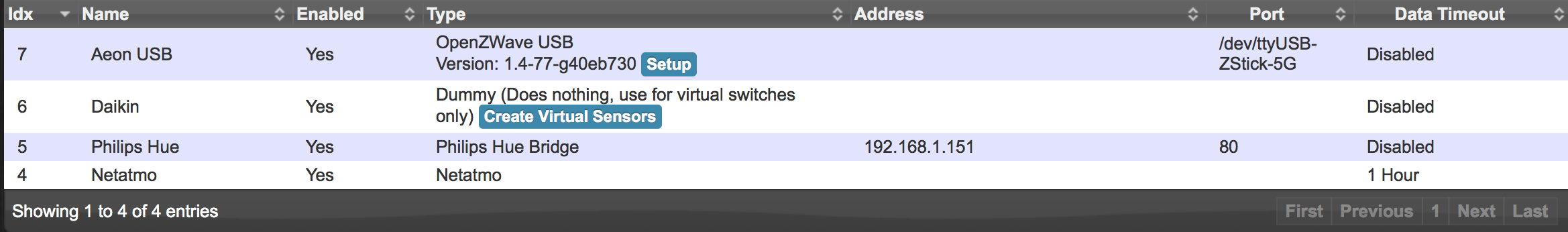

- bbqkees
- Posts: 407
- Joined: Sunday 17 August 2014 21:01
- Domoticz version: 4.1x
First follow the following guide so the ZWave stick will always have the same USB port number after reboot.course66 wrote:why fibaro sensor appear as two switches when it is a there-in-one sensor (motion, temperature and light)?
http://www.domoticz.com/wiki/PersistentUSBDevices
Second remove the 'SBFSpot' hardware in your hardware list. This gives the 'wrong' devices in your list.

- Posts: 28
- Joined: Monday 10 August 2015 23:51
- Domoticz version: V2.3202
- Location: Italy
Hi bbqkees,

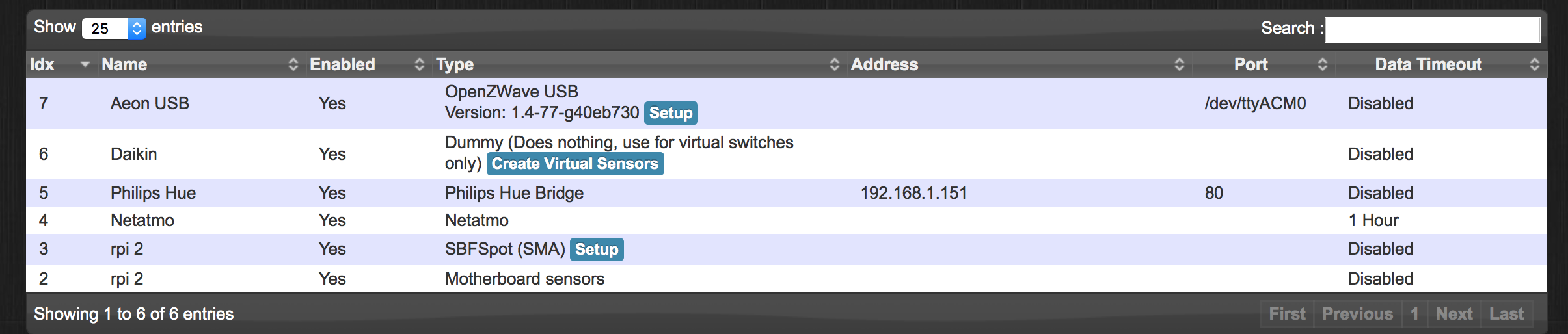

I removed Aeon, made Aeon persistent on usb, deleted SBFspot, re-booted, connected Aeon hardware to new USB port. but...

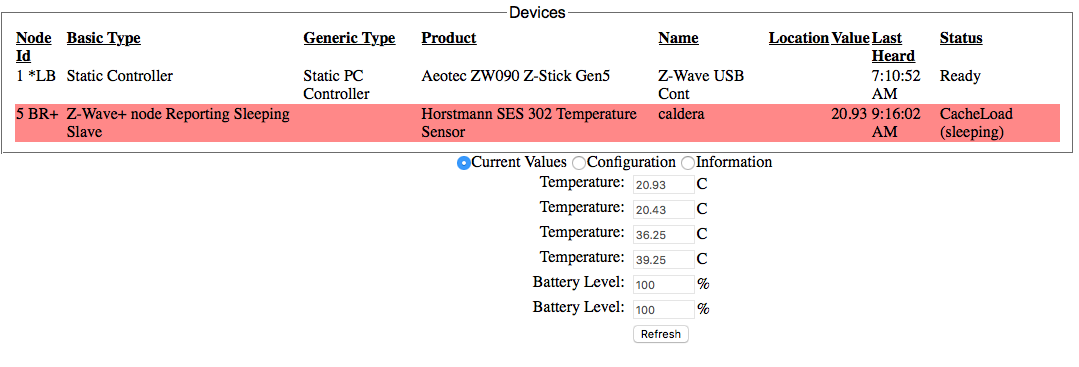

- Posts: 14
- Joined: Wednesday 11 March 2015 22:34

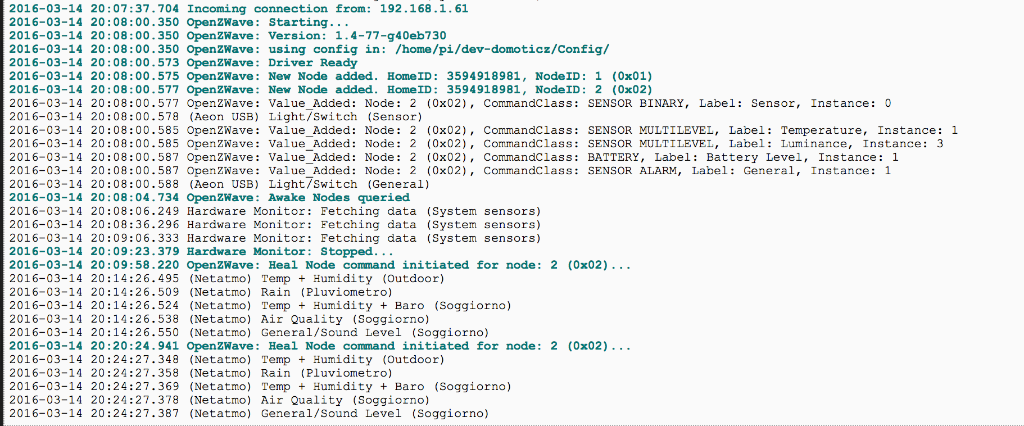

Disable polling for the motion sensor, wake up the sensor by 3x clicking the include button and filter under Devices for Aeon or '00002' and see what shows up. The logging tells you that the Temperature and Luminance nodes are added.
- Posts: 2
- Joined: Thursday 11 January 2018 9:09
Any news on this? Did you find a solution to the problem?
I have the same situation, installed a z-wave sensor (Secure) with 2 probes for tubes temperature measurements, so a total of 3 measurements in the same sensor and even if at the device registration shows in the log the fact that the sensor has different temperature registers I can see only one device in the setup/device menu and indeed receive only measurements for that device.
I can see the channels in the control panel but not as devices in domoticz. My setup is domoticz with Synology NAS and the USB z-wave key.
Thanks for your help.
