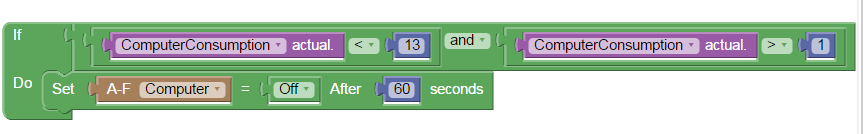

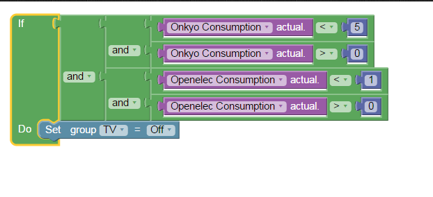

Hello
I have 2 blocky event that works as I like them to do but I like to execute a shell script when this event is triggered and what I can understand can't be done with blocky
I have never worked with LUA, done some bash scripting that is all.
I guess I can learn LUA but what I have read feels nothing that I'm looking for.

Re: Blocky to lua
Hallo Varazir
i would it write it in LUA :
ComputerConsumption = tonumber(otherdevices_svalues['ComputerConsumption'])
if ComputerConsumption < '13' and ComputerConsumption > '1' then
wait 60000
commandArray['Variable:Computer'] = 'Off'
OnkyoConsumtion = tonumber(otherdevices_svalues['Onkyo Consumtion'])
OpenelecConsumption = tonumber(otherdevices_svalues['Openelec Consumption'])
If OnkyoConsumtion < '5' and OnkyoConsumtion > '0' and OpenelecConsumption < '1' and OpenelecConsumption > '0' then
commandArray['TV'] = 'Off'
the command "Wait 60000" are not avaibele in Lua. I would it do with a "delay Funktion " in the Switch Propperties.
I think, the TV is never go Off because, there is no value between >0 and <1.
wait 60000

Thankscompuman wrote:Hallo Varazir
wait 60000
Found thiscompuman wrote: the command "Wait 60000" are not avaibele in Lua. I would it do with a "delay Funktion " in the Switch Propperties.
http://stackoverflow.com/a/13263109
local clock = os.clock
function sleep(n) -- seconds
local t0 = clock()
while clock() - t0 <= n do
endHmm, It's due to the raspberry PI consumes 2.2W when running and about 0.4 W when it's turned offcompuman wrote: I think, the TV is never go Off because, there is no value between >0 and <1.
I'm using non standard notification system, going to call a bash script that pushes out a msg to my phone.
If ComputerConsumption < 15 and ComputerConsumption > 0; then
execute scrip/notification.sh "Computer" "#Domoticz" "Computer is shutdown, powering down in 20 seconds" &
sleep 20
sleep 5
set computer = off
execute scrip/notification.sh "Computer" "#Domoticz" "Computer is online again"
exit
fi
fi
