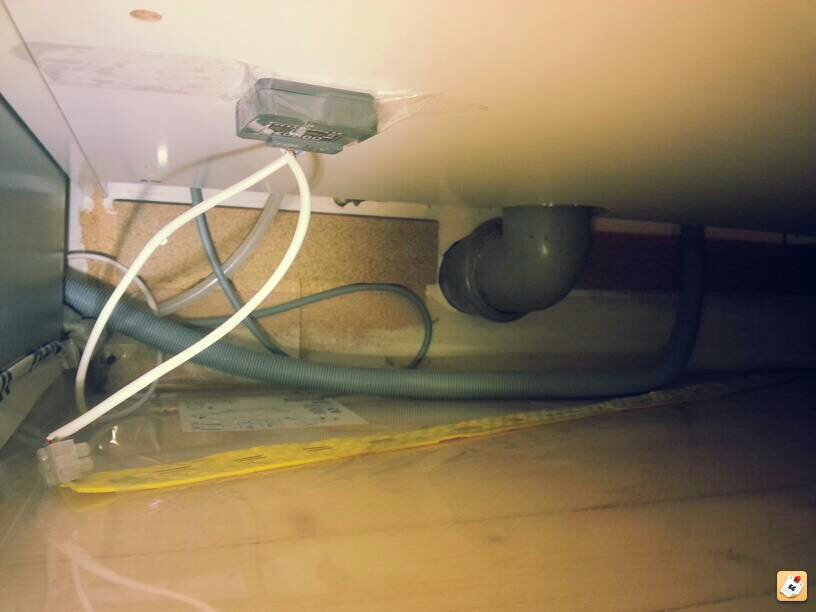

Received the stuff today.
Looks good for the price.
Have done some testing.
Enabled the Lightning4 protocol.
Added the battery and dipped the water sensing part in a glass of water, no cigarr.
Made the changes suggested by b_weijenberg a few posts up.
Now i can get it in as Lightning4 switch :-)
However, the switch in Domoticz stays always on (lit) and can't turn it off.
When i dip it water i can see in the logs that it transmits.
2016-03-05 12:18:32.279 (RFXCOM) Lighting 4 (Vattenlarm)
How do i see what kind of message it sends so i can make a LUA script taking care off the alarms.
Or, maybe it should be added as some other kind if switch??
Gert

This type of sensor transmit only the ON packet if the sensor is triggered. The state must be changed to OFF by software. Set the state back to OFF after a delay of a few seconds.

Ok, got it to work.
Created a dummy switch that the sensor switch can turn on.
I hided the sensor switch with the $ sign.
A lua turns on the dummy switch the a leakage is detected and sens an Prowl message.
if (devicechanged['$Vattenlarm']) then
    print "VattenLarm AKUT"
    commandArray['Läcka Kök']='On'
Works as a charm.
Well worth the money.
Thanks for bringing this up in the first place :-)
