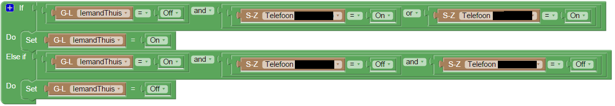

As far as I can see, in the second part, you should have AND instead of OR between the phones. As it is now, just one phone fulfils the condition and swithc is set to OFF. Next, it detects one phone and sets it to ON again.Martijn85 wrote:Hello everybody,
Maybe someone can help me out with this small issue. These are my blocks:
This works but when one phone is off and one phone is on the switch Iemand Thuis (Someone Home) is switching every second from on to off. When the second phone is coming online the switch keeps on like ik should. Why, when one phone is off, the switch is switching from on to off?

Thanks for the fast reply mKotek, it seems that did the trick! Thank you

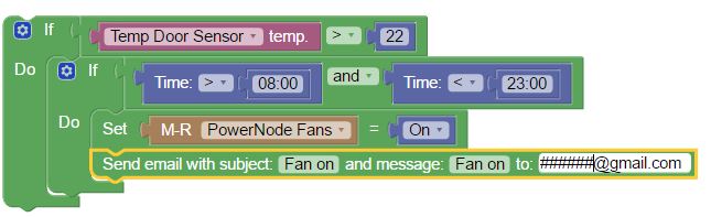

how to set a if-do inside a if-do?Jochen wrote:Turn on a Light when open a door

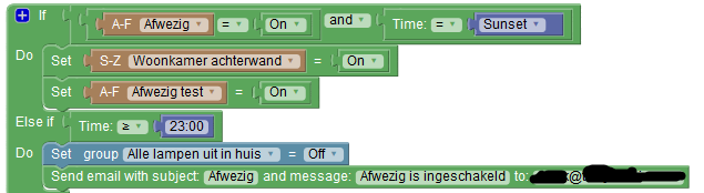

I have made my first blocky event.
Is it possible to test this, without waiting till the sunn is under? (simultion of a day)
The script is sending nog from 23:00 till 00:00 email, a lot of emails!! I just want one email that i am not at home. How to do this? Thanks for reading,
Mark

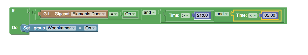

so what am I doing wrong here? this feels so straight forward but it doesn't work

Please try again with setting the group to "on" instead of "active",micbou wrote:so what am I doing wrong here? this feels so straight forward but it doesn't work
this works for me.

Unfortunatly not working neither. Time doesn't seem to work in any scenario and Domoticz does show the correct time.

Re: Blockly examples
and its weird because below does work
