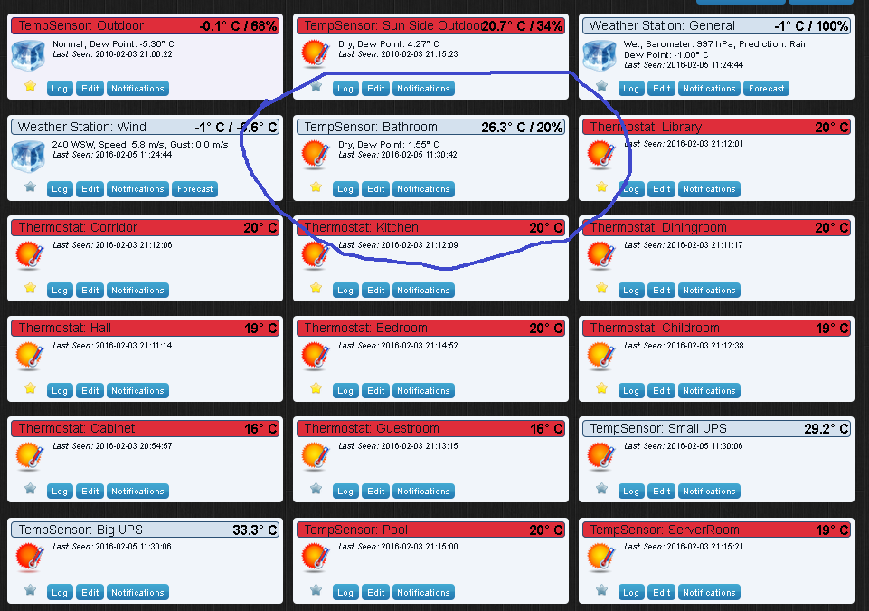

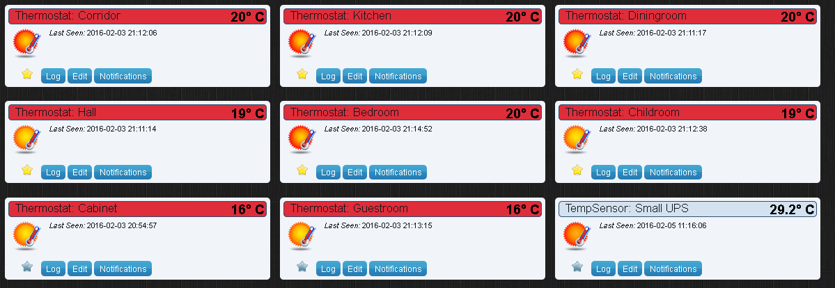

couple days ago i have got red temperature sensors (temp_sensors.png). I use Oregon sensors and Digimax thermostats in my project, both used Oregon protocol to communicate with RFXCOM. I think i have got some problems with RFXCOM receiver, and reboot my
Odroid. Nothing happens, temperature sensors was lost. I thikk my RFXCOM is died, and replace it with spare one. Just the same situation. I replace my power source for Odroid - just the same. In the lig-file i can see:

In addition, just one sensor of 12 still work:
2016-02-05 11:27:58.149 (RfxTrx Interface) Temp + Humidity (TempSensor: Bathro
and it is really alive (work_sensor.png)/ Шежы not most closest sensor to RFXCOM, i don't know why it still work.
Summing, i have lost ability to receive temerature sensors info via RFXCOM (exept one sensor (???)) via Oregon protocol and

eagapov
Posts: 10
Joined: Wednesday 13 August 2014 9:44
Domoticz version: Stable
Location: St.Petersburg, Russia
Re: Problem: RFXCOM partially lost receiving ability
Post by eagapov »
Yes, of course. In logging - all OK, but completely absents any marks of receiving information from thermo-sensors (except one working).
Below - example:
it's - receiving from one working sensor (2nd line from bottom)
2016-02-05 10:44:07.377 User: Admin initiated a switch command
2016-02-05 10:44:07.378 (Presence) Lighting 1 (Big UPS Power)
2016-02-05 10:44:07.671 Executing script: /home/pi/domoticz/scripts/domoticz_m$
2016-02-05 10:44:07.692 Executing script: /home/pi/domoticz/scripts/domoticz_m$
2016-02-05 10:44:20.002 Hardware Monitor: Fetching data (System sensors)
2016-02-05 10:44:39.167 (Pinger) Lighting 2 (Pool Camera)
2016-02-05 10:44:39.714 Executing script: /home/pi/domoticz/scripts/domoticz_m$
2016-02-05 10:44:41.087 (Weather Underground) Temp + Humidity + Baro (Weather $
2016-02-05 10:44:41.123 (Weather Underground) Wind (Weather Station: Wind)
2016-02-05 10:44:41.141 (Weather Underground) UV ($Weather Station: UV Index)
2016-02-05 10:44:41.159 (Weather Underground) Rain (Weather Station: Rain)
2016-02-05 10:44:41.177 (Weather Underground) General/Visibility ($Weather Sta$
2016-02-05 10:44:50.138 Hardware Monitor: Fetching data (System sensors)
2016-02-05 10:44:55.166 (RfxTrx Interface) Temp + Humidity (TempSensor: Bathro$
2016-02-05 10:45:06.585 EventSystem: Script event triggered: /home/pi/domoticz$
it's - X10 commands receiving (1. 4. 8 line)
2016-02-05 08:39:09.671 (RfxTrx Interface) Lighting 1 (Heater: Water Boiler)
2016-02-05 08:39:10.096 Executing script: /home/pi/domoticz/scripts/domoticz_m$
2016-02-05 08:39:14.947 User: Admin initiated a switch command
2016-02-05 08:39:14.954 (RfxTrx Interface) Lighting 1 (Heater: Kitchen)
2016-02-05 08:39:15.142 Executing script: /home/pi/domoticz/scripts/domoticz_m$
2016-02-05 08:39:24.380 Hardware Monitor: Fetching data (System sensors)
2016-02-05 08:39:25.668 User: Admin initiated a switch command
2016-02-05 08:39:25.675 (RfxTrx Interface) Lighting 1 (Heater: Kitchen)
2016-02-05 08:39:26.162 Executing script: /home/pi/domoticz/scripts/domoticz_m$
2016-02-05 08:39:29.777 User: Admin initiated a switch command
2016-02-05 08:39:29.783 (RfxTrx Interface) Lighting 1 (Heater: Corridor)
2016-02-05 08:39:30.194 Executing script: /home/pi/domoticz/scripts/domoticz_m$
