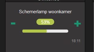

SwordFish
- Posts: 278
- Joined: Sunday 14 December 2014 12:28
- Domoticz version: V4.11375
@G3rard
Its working
Thanks for helping
Its working
Thanks for helping
