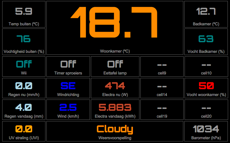

Most important changes:
- The html is cleaned and structured. User settings are now only at end of script.
- All cells are numbered. If cell is not defined in user settings, the cell number appears on screen
- User can now easily set the label of the cell in the user settings (like 'Temperature Livingroom')
- User can now set optional alarm value. Of value of sensor above this value, the text will turn to RED.
- User can easily adjust the color of the text.
- If defined cell is a switch, the cell is clickable to switch that device.
How to install?
- copy attached frontpage.html to the Domoticz ditrectory (domoticz/www)
- Create a roomplan in Domoticz and add devices to that roomplan
- Adjust user settings in frontpage.html: the URL of your domoticz, the number of your roomplan and the devices to display
- If log-in for Domoticz is required, it best to add the IP of the device displaying the frontpage to the settings in Domiticz, so no login is required.
- Open in browser [your Domoticz IP]:8080/frontpage.html

I like the layout very much. But does not seem to get it working.
Edited the User veribles:
example:
$.roomplan=8; // define roomplan in Domoticz and create items below.
$.domoticzurl="http://192.168.1.243:8080";
'59', 'Temp', 'cell3', 'Temp Outside (ºC)', 'color:darkorange', '>25'],
This gives me nothing...
also tried:
$.domoticzurl="domoticz.pipari.nu:8080";
What do I miss?
See attached image

Hi Pipari,
When you enter this URL in a browser, does it give any result?
http://192.168.1.243:8080/json.htm?type=devices&plan=8
Hans

I already succeeded
Changed it to some other Google font
Some other points:
- Do you know how to get my today's gas consumption in the page? I have my Domoticz connected to my smart meter (P1).
'CounterToday' is working for electrics, but not for gas (item is not shown then). How do i know what type my device is? Which JSON command can i run to determine?
- And it also seems it can't get the status of a protected switch? I have a switch that controls a GPIO pin. I already have made it unprotected, but still not visible.
- And i have a dimmer, but that one messes up the layout:
(my eettafel (cell 12) is a dimmer)
- And how can i give the words 'on' and 'off' different colors? I would like to have 'On' in green, and 'Off' orange... But can't find how to do it. It looks like the words are directly used from the JSON.
I now have this:
The texts for On and Off do have different colors (blue and green) now, but now i can't click them anymore. I have the feeling i am very close, but can't get it working

I got it
I modified (or better: left out) parts of the alarmcss, and put in my own code.
Switch is now green when on, and orange when off. The protected/virtual switches are now also suddenly working (something wrong with the original alarmcss code).
Gasmeter was also 'CounterToday'.
Code can be found here:
http://pastebin.com/4gCp13aJ
Things i am still not happy about:
- The dimmer level that is shown huge... For me on/off would be fine, i almost don't change the level, and otherwise would be possible from Domoticz, to keep this interface neat and tidy (no unneccasary dim sliders)
- Protected switches can now be clicked on, and changed from off to on or vice versa > not what you want.... Maybe implement an extra check so a switch cannot be controlled if it is protected? (protected yes/no should already be in JSON data).

@hansbit: pagearray is the array used for the switches etc.
I now see I type some in Dutch
I think this will make me look for a 7" tablet for wall mounting.
First I will have a look at the changes thinkpad made, because I also like that font better.
And see if the scene adaption can be made better compared to just copying all the code.

Created something to display/use a link. Not sure if I am goinf to use it, but anyway, below is how I did it.
Add this to the uservariables:
And this after the last } of the if statement that looks like : if ( $.PageArray[ii][0] === item.idx )
['0','Link', 'cell22', '<a href="http://www.nu.nl" target="_blank">NU.nl</a>'],
else if ( $.PageArray[ii][0] === '0' ) { //Special nummer, link in cell (test)
var vlabel= $.PageArray[ii][2]; // cell number from HTML layout
var vdata= $.PageArray[ii][3]; // description (link in this case
var vdesc = '';
$('#'+vlabel).html( '<div>'+vdata+'</div>');
$('#desc_'+vlabel).html(vdesc);
ThinkPad
