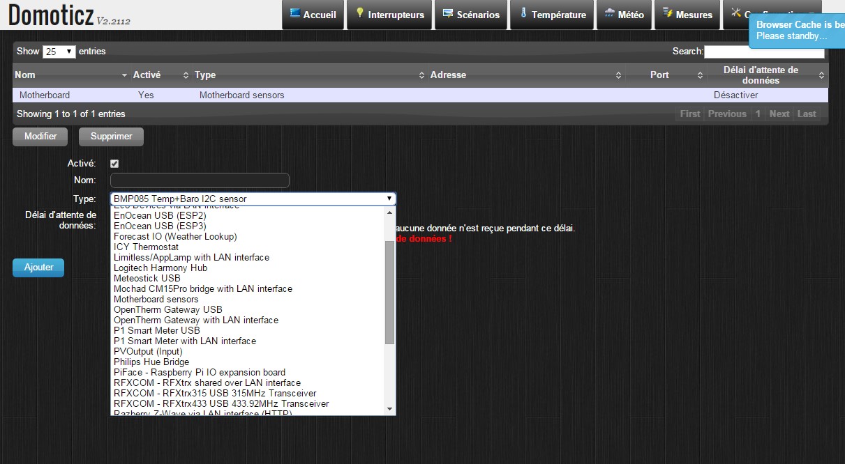

tanebisse
- Posts: 2
- Joined: Tuesday 17 March 2015 8:58
domoticz in synology as package! Available now.
I have the same problem as moonface.
I installed the Domoticz application on My Synology with the package automatically.
But I don't have any device type for my Aeon Lab Z stick on dropdownlist (see domoticz.jpg).
How can I install an Open Z wave pakage to recognize my device ?
- domoticz.jpg (157.7 KiB) Viewed 4636 times
