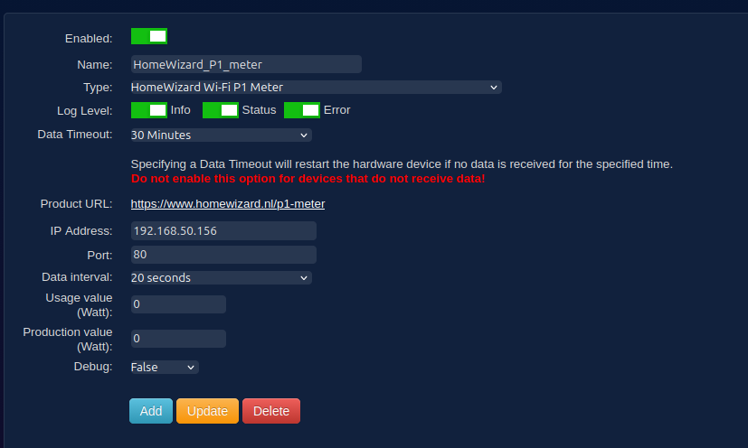

rini52
- Posts: 44
- Joined: Friday 10 June 2022 23:19
- Domoticz version: 2025.2
Re: Using P1-device form Dutch Homewizard
this is what I used:
https://github.com/etmmvdp/HomeWizard-B ... /tree/main
and never had a problem. You create some sensors and of you go.
Added some summary scripts and never had a problem
Regards Rini
see:
viewtopic.php?t=43321
Regards Rini
see:
- Screenshot from 2025-12-01 17-28-55.png (51.6 KiB) Viewed 106 times

but the plugin does have a parameter you can change in the code:
and when you use the "P1-WiFi-Gateway" hardware, you can change the frequency in the hardware setup page.
