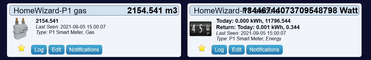

For the newbies (like me), script needs to be under in the folder /scripts/lua_parsers and you want to use the "Idx" value as shown under devices (not "ID")
Also, the values look a bit mess up, is this expected?

Hirboerdijk wrote: Sunday 05 September 2021 14:28 For the newbies (like me), script needs to be under in the folder /scripts/lua_parsers and you want to use the "Idx" value as shown under devices (not "ID")
i got the same issue with negative values coming from the P1 meter
I found this solution...
https://github.com/domoticz/domoticz/issues/4521

Hibrax wrote: Sunday 26 September 2021 0:56Hirboerdijk wrote: Sunday 05 September 2021 14:28 For the newbies (like me), script needs to be under in the folder /scripts/lua_parsers and you want to use the "Idx" value as shown under devices (not "ID")
I found the solution in the Lua script (a little bit trial & error)
don't forget to change the idx numbers

works great for my belgian digital meter with the homewizard P1-meter

The Homewizard dongle reports correct values for instant watt consumption, but Domoticz shows values multiplied by 10 (except in the device log).
So the hardware is not to be blamed.
The plugin has initially created a device of Type=243, Subtype=29 . Is this correct ? Where can I find a reference of Types and Subtypes ?
Anyway thanks for your reply !
