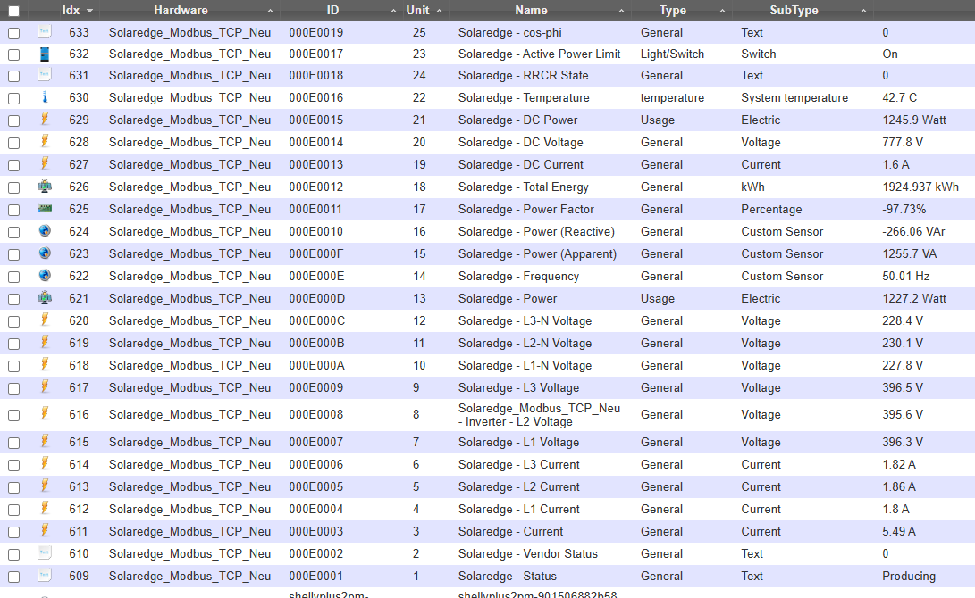

Re: SolarEdge production throttling from Domoticz
Post by imautohuttraeger »
Sorry, that i took so long. Finally now I have de-installed the current master and installed the MetersDev Branch. There are more devices now including the dimmer switch - see Screenshot. But there is no batterie.
Do I use the correct versions?
Version: 0.8.0
Version: 3.6.9
