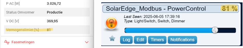

I've been exploring ways to regulate the power production of my SolarEdge SE5000H with display using Modbus over TCP/IP. Until now, I've relied on "sunspec_ardexa" to retrieve data, but that functions purely as a background process.
Recently, I came across the Modbus TCP plugin developed by Addie: [GitHub Repository]( addiejanssen/domoticz-solaredge-modbustcp-plugin ). After discussing and troubleshooting a few issues, I found that it works well, which led me to consider integrating a Dimmer-type device. This device would display a 0-100% value corresponding to the Modbus registry key "active_power_limit" (F001), as outlined in the Power Control Protocol for SolarEdge Inverters Technical Note.
Since development on the original GitHub repository appears to have stalled, I started exploring similar implementations, like the simple slider used in Home Assistant. I then modified a copy of the original code to include an additional Dimmer device. This new feature displays the current "active_power_limit", and adjusting the dimmer level updates the SolarEdge inverter with the new limit.
The Power limitation is tested and working as expected. There are currently 3 Branches available on my cloned github repository:
Original Master (v1.1.1) updated (2-7-2025) with the active_power_limit Dimmer&Sync (v1.2.4) option:
https://github.com/jvanderzande/domotic ... tcp-plugin
Original METERS (v2.0.4) updated with the active_power_limit Dimmer&Sync (v2.0.4.2) option:
https://github.com/jvanderzande/domotic ... ree/meters
Development MetersDev branch (v2.0.5.2) (2-7-2025) based on my meters branch using the latest solaredge_modbus and Selector Switches for Battery modes:
https://github.com/jvanderzande/domotic ... /MetersDev

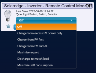

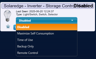

The 2 extra battery selector switches still need testing by somebody that has this installed and would like to get feedback on that.

Can you actually set a limit like 500 Watt, or 0 Watt? Or is it a percentage? (0-100) in SolarEdge?
- jvdz
- Posts: 2490
- Domoticz version: 4.107
Re: SolarEdge production limitation from Domoticz
It is the actual max power production that can be set to anything between 0-100%.
EG: I have a se5000h so when I set the dimmer to 20% it maximizes the production to 1000W.
Just made my changes available for those that like to test it in this branch: https://github.com/jvanderzande/domotic ... ower_limit
I am using it currently with the requirements.txt:
For those that like to work with version 0.8.0 there is an requirements080.txt that can be used.
pymodbus==2.5.3
solaredge_modbus==0.7.0- gizmocuz
- Posts: 3086
- Location: Top of the world
Then it makes sense to use a dimmer slider... If you could somehow set the actual Watt limit (which would be awesome as you know how many Watts your house need... and not percentage), you could use a Setpoint device (with parameters for Unit (Watt), min=0, max=5000h)
Great work on the plugin!

It is a "Solaredge Home Battery". A stack of 3 x 4.6 kWh = 13.8 kWh. Linked to a Solaredge inverter "SE 10K".
If this off topic issue deviates from the scope of this thread I could of course outsource it to a separate thread.
Stop, look and listen.
- jvdz
- Posts: 2490
Ah ok, so you like this plugin to also retrieve the battery information. Should be a nice option and should be doable, but I don't have any connected so would be hard for me to code/&test.
In this file on github you can find the registry options currently used in this plugin and it needs to be figured out what is required for the Battery info.
This project for HASS, which also has the powerlimit option I added, has it build in to check for the Battery option.
