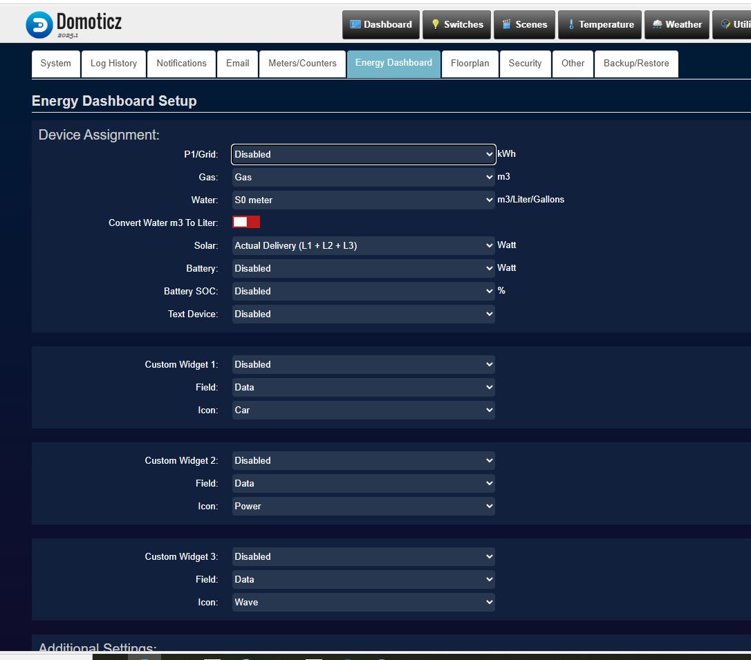

I cant get a reading of electricity on the energy dashboard.
At the settings for energy dashboard I can not select the device at P1/Grid can only choose disabled. any ideas?

- energy dashboard2.JPG (91.72 KiB) Viewed 1406 times

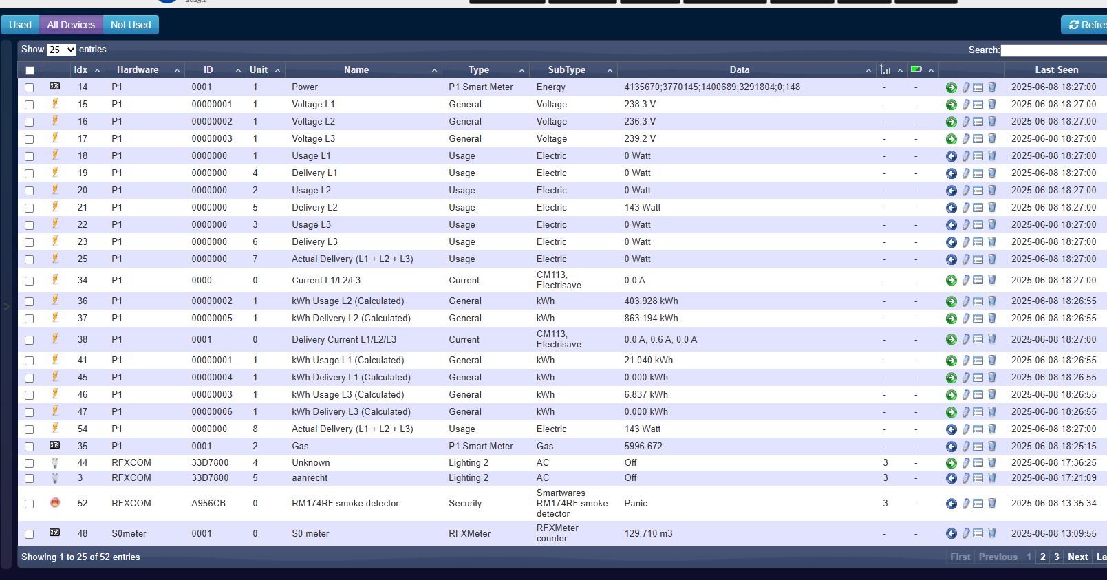

Do you have devices activated for the P1 Hardware devices?
Can you show a list of the P1 devices in menu Setup - Devices?

sure thing;

Why do you have that P1 device selected for Solar?
Think you should remove that and then check the dropdown for P1, which should contain Power (IDX 14)

I see IDX 14 is set to unused(the little green arrow) click this to 'Add device'

Thanks RonkA,
Got a reading from the grid now, nice. Too bad the solar still reads 0 KW, according to the app of my inverter it should read 313W now.
In energy dashboard I have at Solar: Actual delivery L1+L2+L3.
At devices I cannot find the delivery of the solar inverter
