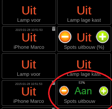

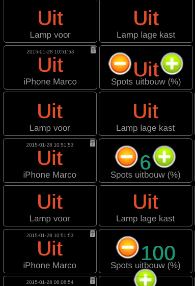

As you can see in the example, the layout of that particular cell is....eh....not the way it should be. The images and the text need the right alignment.jan_nl wrote:I am not completely sure what you mean, can you post an example?
There is one thing that might be even better: is it possible to put the % in the place where the last seen (in other cells) is placed, and the On / Off will be in this cell (with the pop-up)? I don't know if I'm making myself clear....
EDIT: I removed the 'width=50' for the PLUS and MINUS images, they are way too big in this example. But it doesn't solve the 'problem' described earlier.
Edit 2: I used Paint
Edit 3: Just add the 'align=left' to the - button, and add 'align=right' to the + button. The buttons AND the text will be placed the way all other text is placed. So far do good!

Ok, this is how I have it now. Remains the question: could it be made like I described in the mock-up
