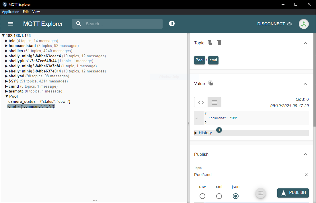

I have a camera surveillance app (using python paho) that is communicating with domoticz v2024.7 via mqtt broker.
The camera sends status to domoticz and receives commands from domoticz via 2 topics.
I have configured MQTTmapper with a devices file (1 text device for status, 1 on/off switch for command):

The plugin receives the status from the broker but says there is an MQTT protocol error ....

I have no idea what to do now.
I must admit that I am not sure how to correctly create the mqttmapper json file.

This error seems not to be related to configuration (nor MqttMapper), but more receiving an invalid MQTT message from MQTT broker.
Which broker are you using?

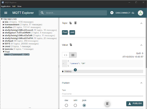

I am using eclipse mosquitto V2.0.18 on windows 64bit on the domoticcz production system.
The broker is working on the domoticz production system with MQTT auto discovery without a problem and communicating with the development server for mqtt AD without a problem.
The 'status' message in the log looks well formatted to me (but i am not an mqtt protocol expert)

Looking at Domoticz code (PluginProtocol.cpp, line 1602), it seems that topic length sent by broker is invalid (4608). Getting deeper in received message, it seems that the length field is missing from received message (and start of topic is used as topic length, giving the error). You can convince your self having a look at
2024-10-04 10:03:37.460 mymqtt: 82 22 00 01 00 12 50 6f 6f 6c 2f 63 61 6d 65 72 61 5f 73 74 ¢....Pool/camera_st
2024-10-04 10:03:37.460 mymqtt: 61 74 75 73 00 00 08 50 6f 6f 6c 2f 63 6d 64 00 .. .. .. .. atus...Pool/cmd.

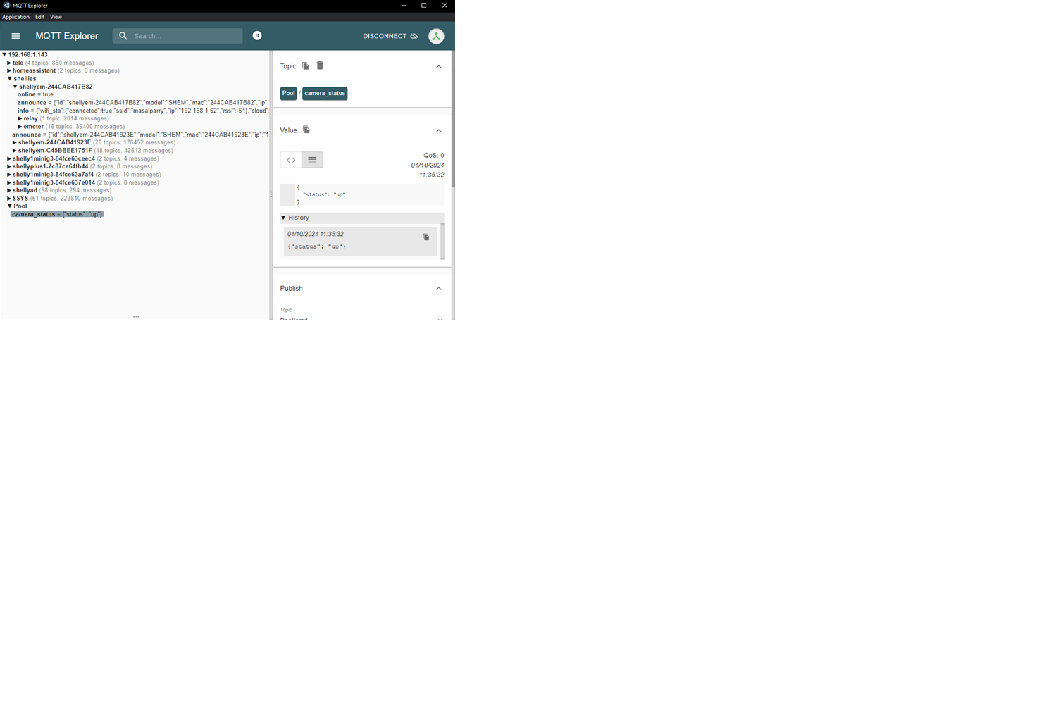

This is strange. The camera app is mine and uses the python paho client to send the status to the broker
mqttpayload=json.dumps({"status": "up"})
(rc, msgid) = mqttclient.publish(camera_name+'/camera_status', payload=mqttpayload, qos=1,retain=True)
mqtt explorer.png (118.4 KiB) Viewed 6305 times
Because it looked OK in MQTT explorer I assumed it was sent OK by the application

Even stranger: you send message with QoS=1, and MqttExplorer gives a QoS=0...
What's the output of dumpMqttMapperValues.py?
What the result if you add --wait=2 in dumpMqttMapperValues command line and try to restart camera, at least to send a new message?
mqtt explorer.png (49.51 KiB) Viewed 6280 times

i have done the following ...
1. Upgraded mqtt mapper to latest version
2. Set a minimal devices file
"Pool Camera Switch": {
"topic": "Pool/cmd",
"type": "244", "subtype": "73", "switchtype": "0",
"set": {"payload": {"command":"#"}},
"mapping": {"item": "command","values": {"OFF": "0", "ON":"100"}}
3. Stopped the camera app so that it cannot send or receive mqtt messages
4. Deleted all mqtt broker messages for pool
5. Restarted domoticz
5. Enabled plugin
6. Clicked on domoticz switch
7. PROTOCOL VIOLATION
mqtt explorer before click.PNG (62.56 KiB) Viewed 6236 times
mqtt explorer after click.PNG (67.36 KiB) Viewed 6236 times
