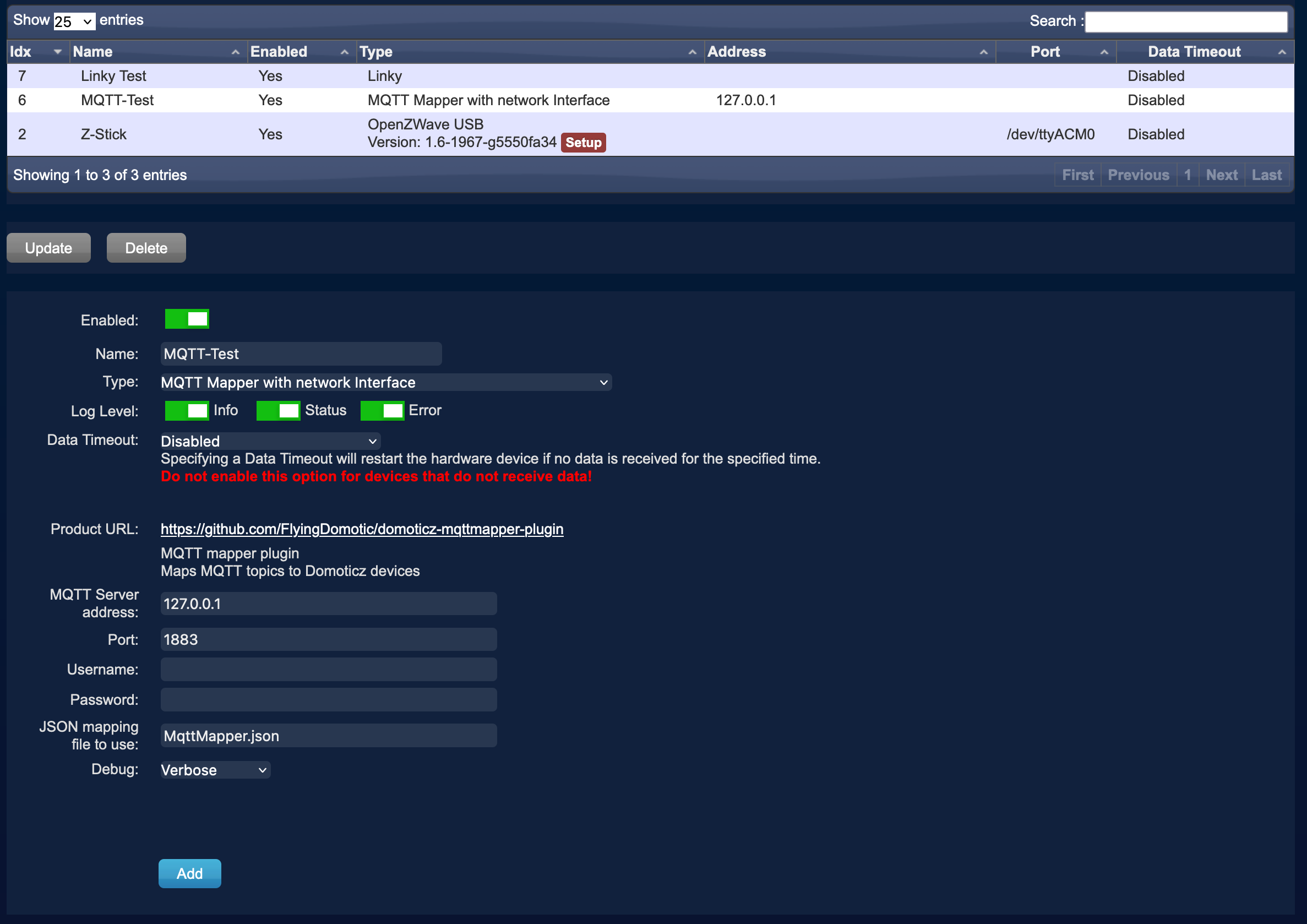

- Posts: 24
- Joined: Monday 12 September 2016 9:00
Re: Python Plugin: MqttMapper
I found, and fixed, the issue with the disappearing settings as a.o. reported by @Hencor in this post.
Believe it or not, but this is caused by the name tag in the plugin definition:
Apparently this is not (all) treated as a string. The word "LAN" seems to have a special meaning in Domoticz. When changing the name to something without "LAN" everything works as expected.
So if the plugin definition is for example changed to:
all works fine. As can be seen below.
<plugin key="MqttMapper" name="MQTT Mapper with LAN Interface" author="Flying Domotic" version="1.0.19" externallink="https://github.com/FlyingDomotic/domoticz-mqttmapper-plugin">
<plugin key="MqttMapper" name="MQTT Mapper with network Interface" author="Flying Domotic" version="1.0.19" externallink="https://github.com/FlyingDomotic/domoticz-mqttmapper-plugin">

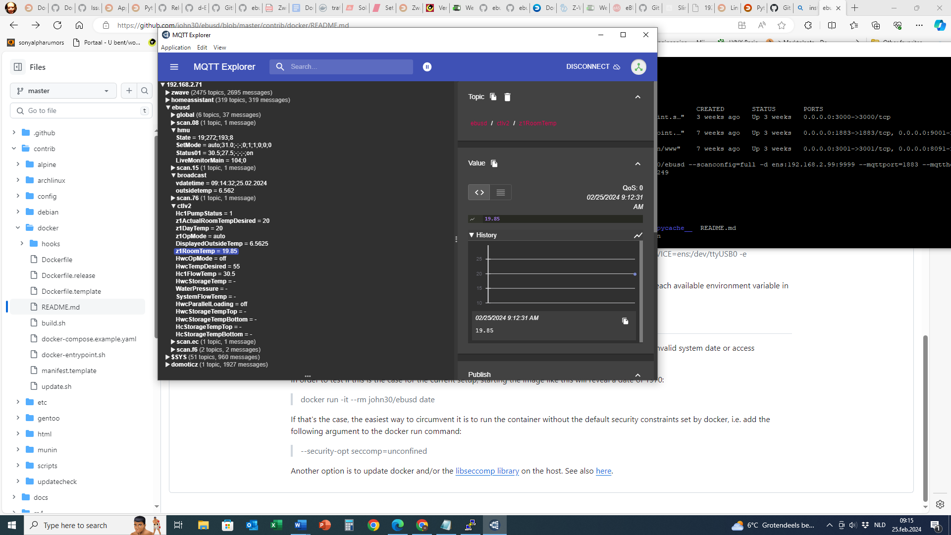

- Posts: 243
- Joined: Friday 12 January 2018 8:26
I could send you the file of the picture of MQTT? I don't know how to get it on here
If I put the file error logs in "extra verbose" extra I don't get anyting?
It is not reading the sValue?

There is an attachment tab for images under the submit button if you select full editor when typing a new reply.
Also check the mqtt debugging section of Domoticz wiki https://www.domoticz.com/wiki/MQTT#Debugging_MQTT

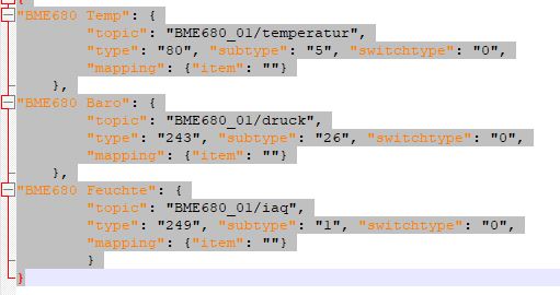

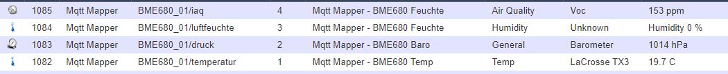

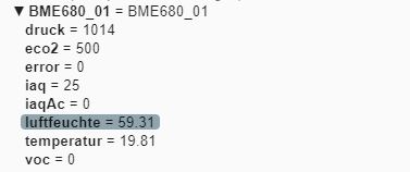

it partially works for me . I get data from a BME680 IAQ sensor from an Arduino D1 Mini. I have transfered the values to the Mosquitto broker and the device appears in Mosquitto. For some reason the Baro device is not available in the Domoticz GUI and for humidity I have not found any type to get the values updated . I have gambled arround several hours with the MqttMapper.json file but do not get a satisfing result. What am I doing wrong?
