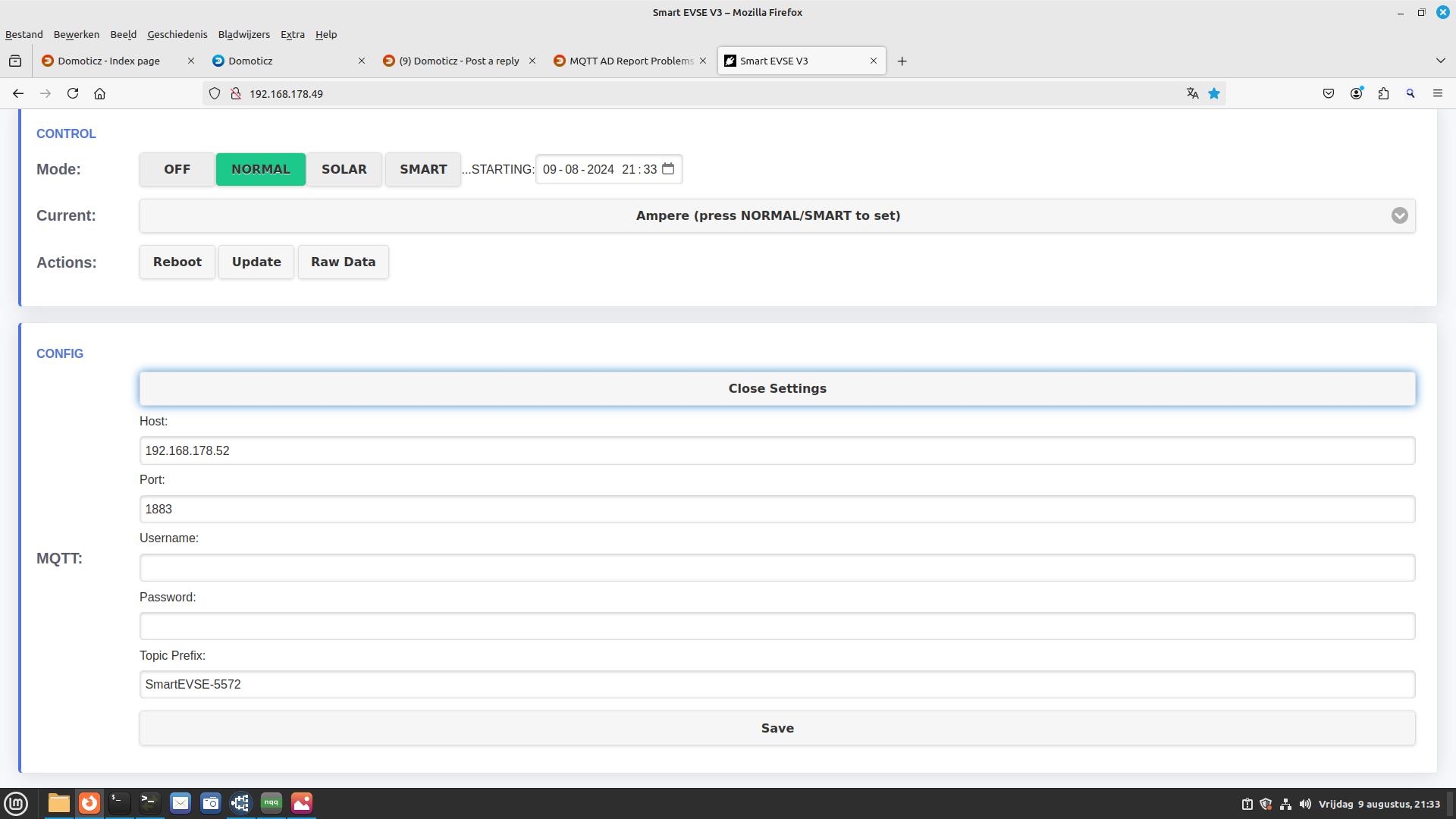

DiaDomo wrote: Friday 09 August 2024 20:33 @rron: please post this screenshot:
and 2 from smartevse without detailed information.
Sorry what do you mean?
DiaDomo
Posts: 37
Joined: Saturday 28 March 2020 13:55
Re: SmartEvse support
Post by DiaDomo »
You said earlier that you also would send a screenshot with the MQTT settings of the SmartEVSE interface, but you didn't send this one yet.

This is the only setting
Schermafdruk van 2024-08-09 21-33-25.png (116.58 KiB) Viewed 2888 times

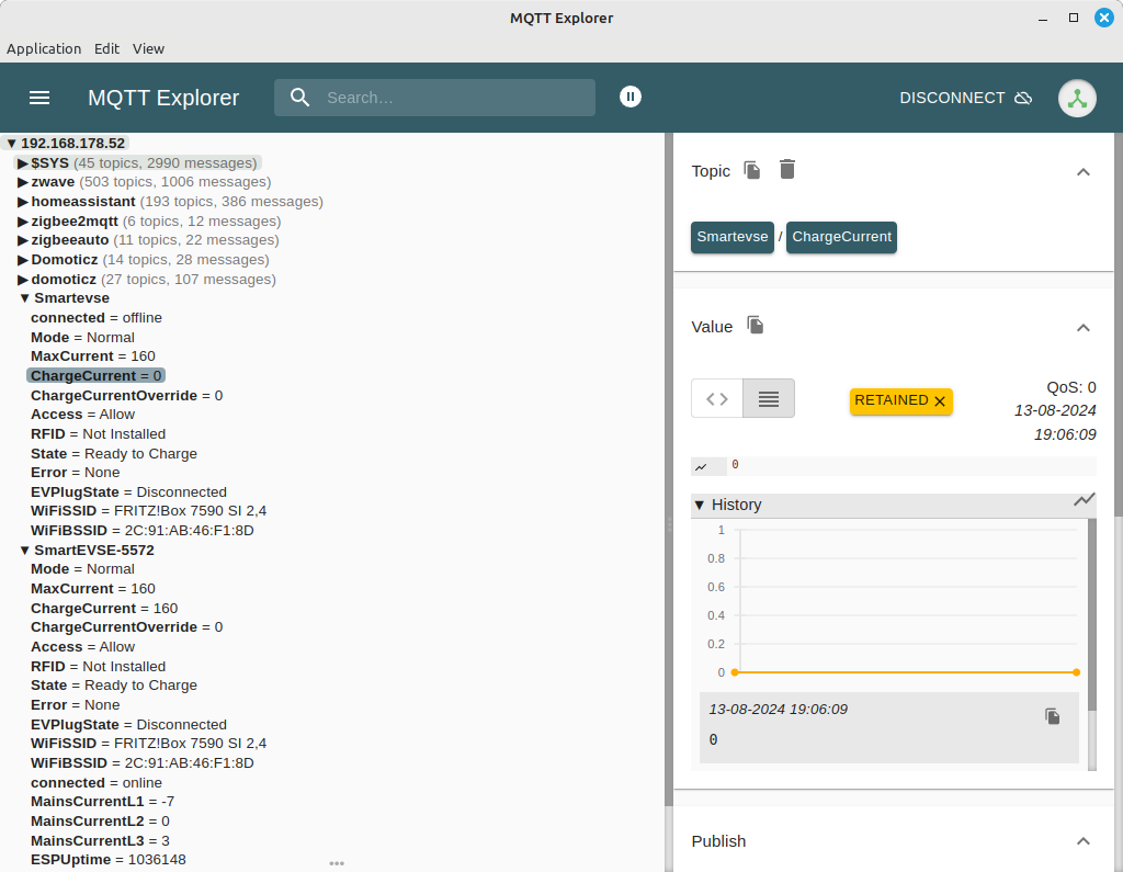

I think it's a bug, If you look at the mqtt explorer you can see the old topic smartevse (previous MqttMapper)and there was the ChargeCurrent 0 and in the latest release you can see the new topix SmartEVSE-5572 and now is the ChargeCurrent 16. The same is for MainsCurrent L1=-7, that should be -0,7
Schermafdruk van 2024-08-13 19-25-03.png (141.7 KiB) Viewed 2693 times
FlyingDomotic
Posts: 463
Post by FlyingDomotic »
Could I have MqttMapper json configuration file?
