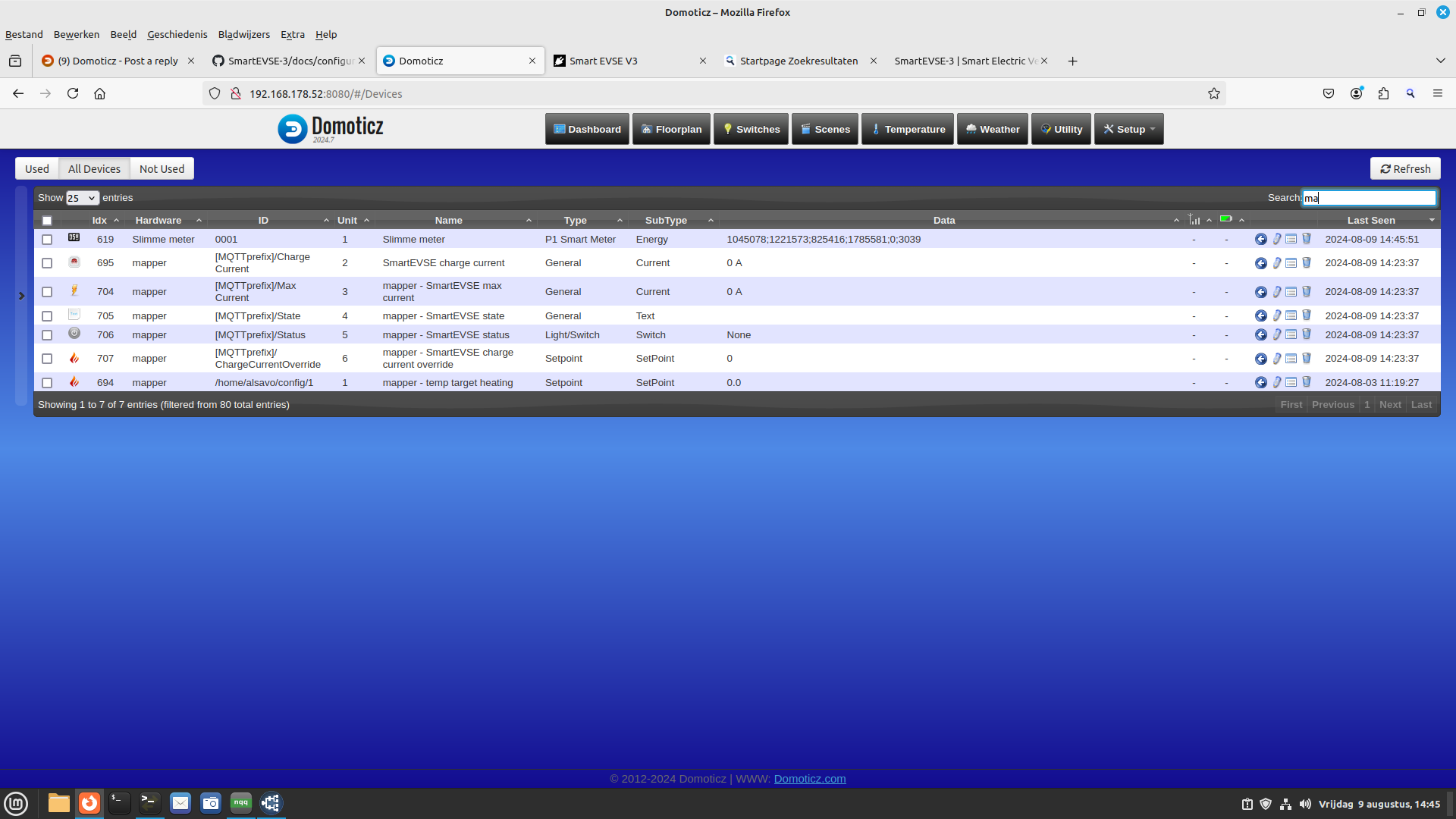

I have the same devices created in my system but there's no update of the devices. The time you see is the creation time. In the logging there's no activity from the mapper.
Schermafdruk van 2024-08-09 14-45-55.png (196.61 KiB) Viewed 2704 times

rron wrote: Friday 09 August 2024 14:48 I have the same devices created in my system but there's no update of the devices. The time you see is the creation time. In the logging there's no activity from the mapper.
Please check with the application MQTT Explorer what SmartEVSE MQTT topics you now have.
Did you change the MQTTprefix in the SmartEVSE configuration (from domoticz to something like SmartEVSE-xxxxx)?
Did you modify the MQTTMapper configuration json with this new MQTTprefix?

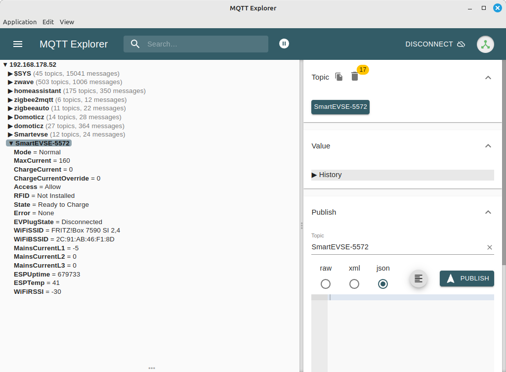

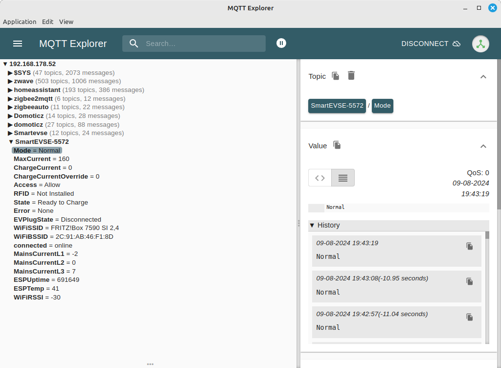

There ' s no further information in the mqtt explorer. I have made 2 screenshots from the explorer, 1 from zigbee2mqtt with information and 2 from smartevse without detailed information.
Schermafdruk van 2024-08-09 19-43-30.png (126.33 KiB) Viewed 2648 times
Schermafdruk van 2024-08-09 19-42-40.png (122.19 KiB) Viewed 2648 times
