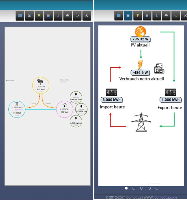

(minor) feature request for the excellent (thanks for it!) new display:
Option for arranging the items also in portrait mode rather than landscape would improve usage e.g. with smartphones.
- Posts: 6685
- Domoticz version: 2025.1
Re: Energy Dashboard (Build in)
Works for me on my smartphone. How does yours look like? You can also zoom in..imautohuttraeger wrote: Sunday 14 July 2024 8:47 (minor) feature request for the excellent (thanks for it!) new display:
imautohuttraeger
- Posts: 172
- Joined: Saturday 14 March 2020 13:40
- Location: Germany
Yes, it is working on the smartphone. But it is very small. Usage of the unused space above and below, with bigger items and larger font would improve visibility. Compare my "solution" - before the nice new energy dashboard existed - with a simple floor plan (please don`t laugh about the amateurish designwaltervl wrote: Sunday 14 July 2024 15:37Works for me on my smartphone. How does yours look like? You can also zoom in..imautohuttraeger wrote: Sunday 14 July 2024 8:47 (minor) feature request for the excellent (thanks for it!) new display:

BartSr
- Posts: 490
- Joined: Sunday 03 July 2016 16:16
- Domoticz version: V2024.7
Can you share how to do this as it's way more better to view on the phone than the integrated energy dashboard.

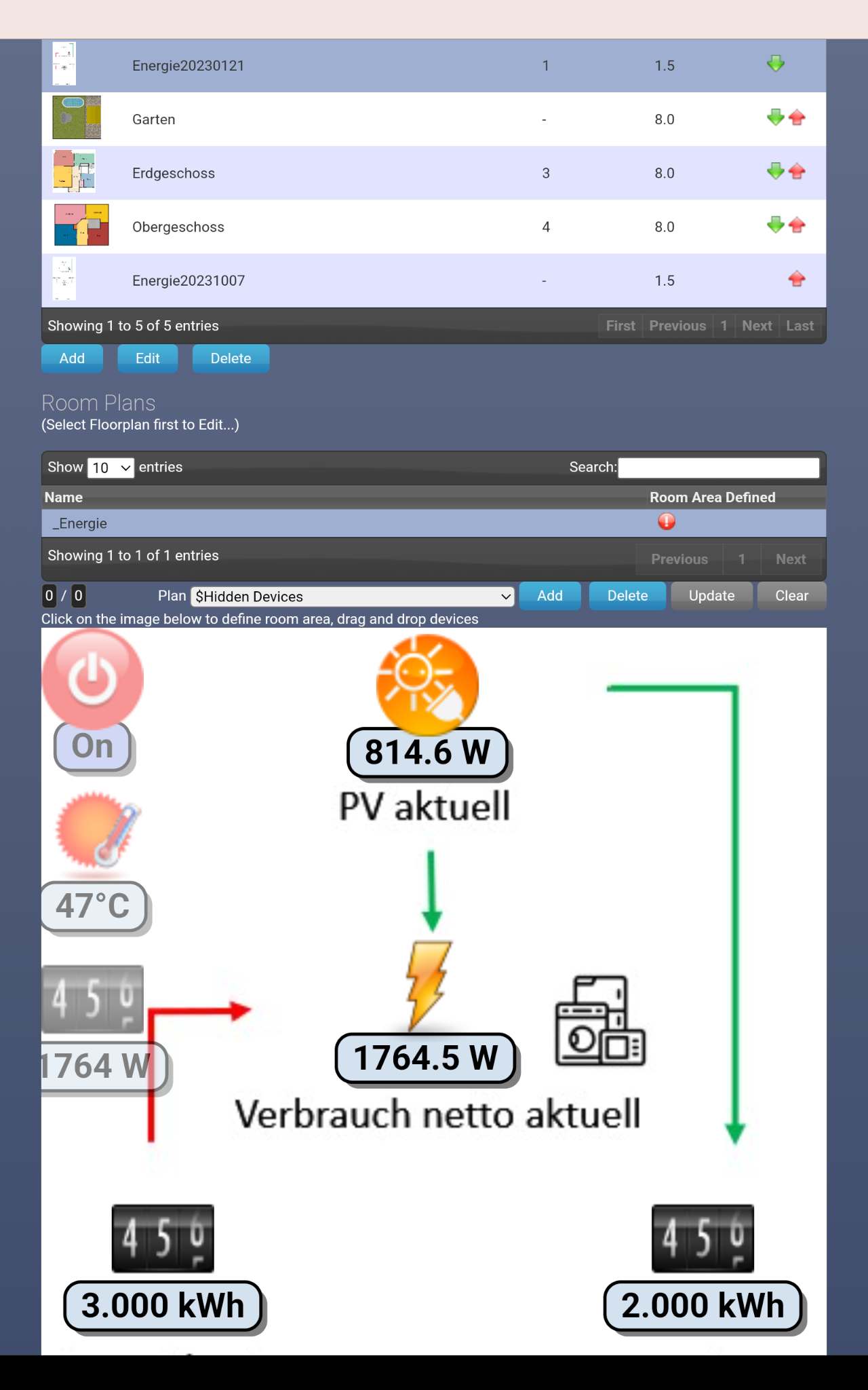

imautohuttraeger
- Posts: 172
- Location: Germany
NOTE: THIS WORKAROUND IS CRAP COMPARED TO THE NICE NEW ENERGY DASHBOARD. It is just a group of devices based on function placed on a background image.BartSr wrote: Monday 15 July 2024 12:28 Can you share how to do this as it's way more better to view on the phone than the integrated energy dashboard.
You have to create a "room" and a roomplan. I have called it Energy. Then you assign the needed devices to this room. Then you create a floorplan which only contains this "room".
This was just my workaround (without any animated energy flow of course) before the energy dashboard existed. I have created a background image (usually it is a floor plan) and placed the necessary devices on it.
https://www.domoticz.com/wiki/Floorplans
- IMG_COM_202407151324376080.jpg (124.19 KiB) Viewed 1664 times

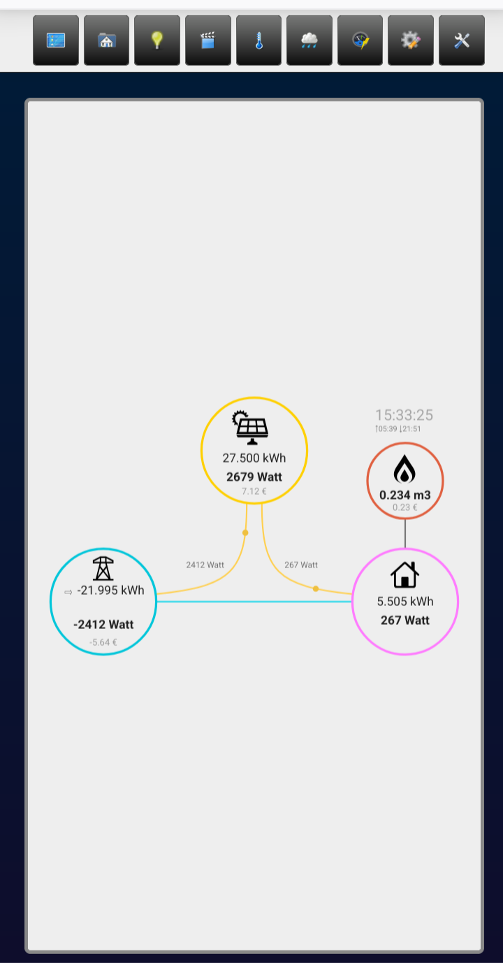

- Posts: 6685
When you have also battery installed it is already less landscape or portait mode. See the screenshot in https://www.domoticz.com/forum/viewtopi ... 69#p318569
So it will be difficult to satisfy everybody's wishes. The workaround to have it in the floorplan has been around for ages.
imautohuttraeger
- Posts: 172
- Location: Germany
That's right. A bigger font size would even be enough. But I think this wouldn't work inside the bullets.
To avoid any misunderstanding: I absolutely love the new Energy dashboard!

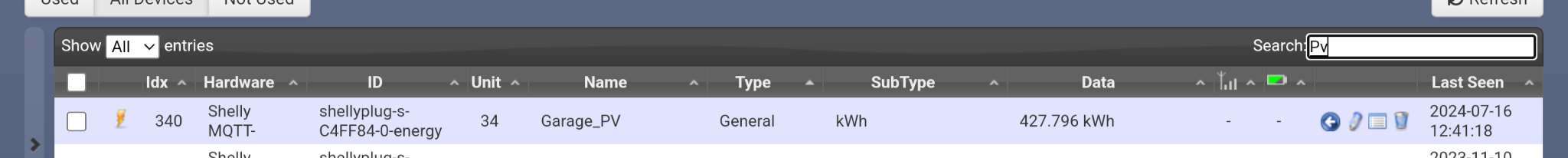

Strangely, it doesn't work for me.

imautohuttraeger
- Posts: 172
- Location: Germany
Don't know if this is the cause. But in my case, type "General" with subtype "kWh" is working (rather than your type "Usage" and subtype "Elektric"). Maybe it is worth a trial.

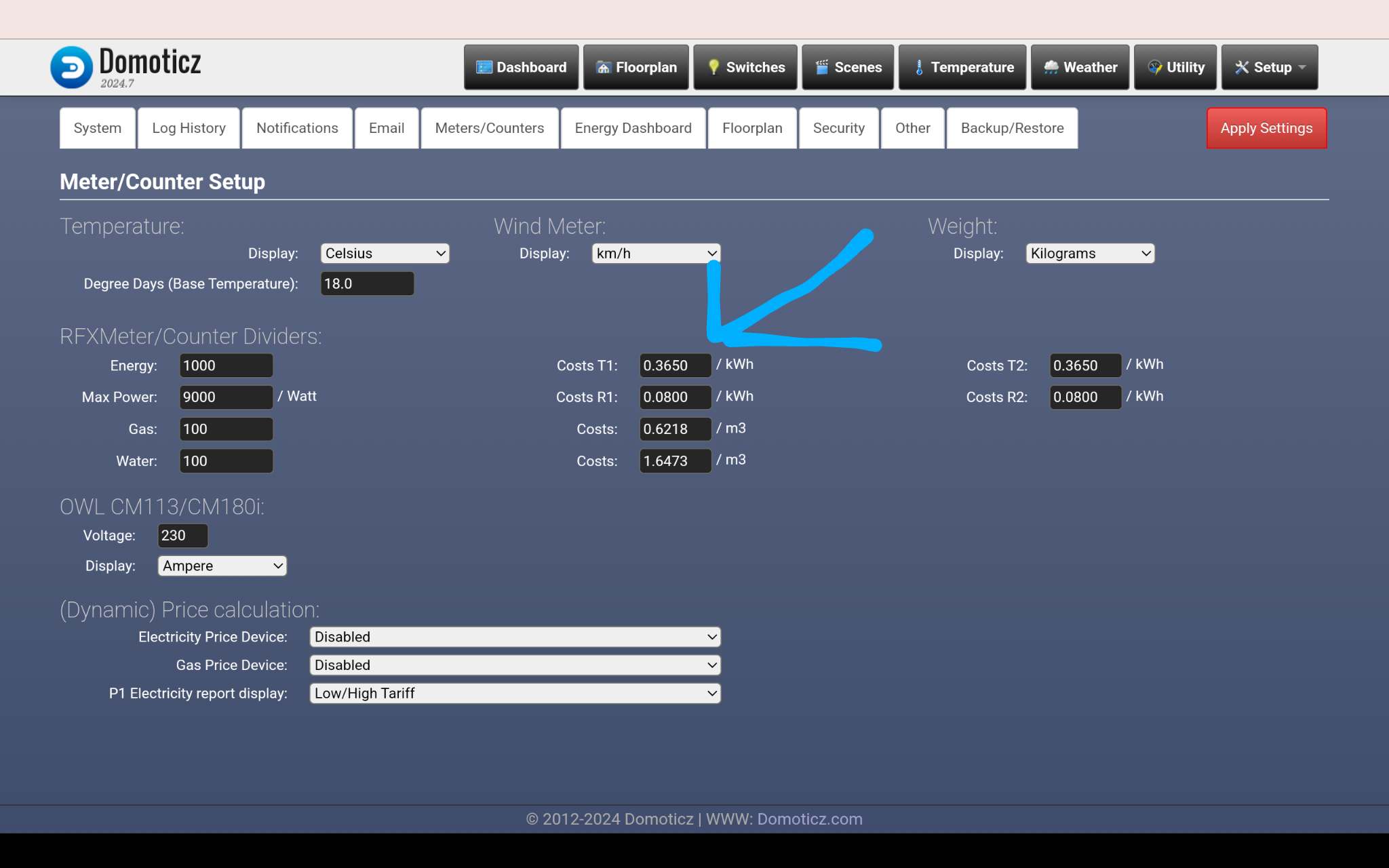

imautohuttraeger
- Posts: 172
- Location: Germany
I don't get the cost fields filled on the energy dashboard. Simple typing in the costs in setup / meters/counters doesn't seem to be enough. Do I need an "Electricity price device"? I tried to choose "Internal (Meter settings) from the drop-down menu without success.
- IMG_COM_202407161305519611.jpg (112.9 KiB) Viewed 1541 times
- IMG_COM_202407161305518470.jpg (53.88 KiB) Viewed 1541 times
I understand, but that's how it is with me.imautohuttraeger wrote: Tuesday 16 July 2024 12:53 Don't know if this is the cause. But in my case, type "General" with subtype "kWh" is working (rather than your type "Usage" and subtype "Elektric"). Maybe it is worth a trial.

- Posts: 6685
You have to enable (Dynamic) price calculation. Select a specific sensor with dynamic price information or use the fixed "internal (meter settings)"imautohuttraeger wrote: Tuesday 16 July 2024 13:14 I don't get the cost fields filled on the energy dashboard. Simple typing in the costs in setup / meters/counters doesn't seem to be enough. Do I need an "Electricity price device"? I tried to choose "Internal (Meter settings) from the drop-down menu without success.
