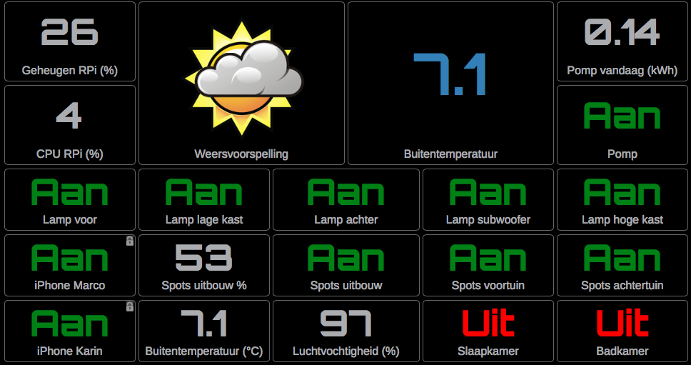

And this is what I have at the moment. It would be great if someone could get a slider (or a + / -) in one of the div's where we can set the level of a dimmer.
- Schermafbeelding 2015-01-13 om 18.07.16.png (106.03 KiB) Viewed 7060 times
