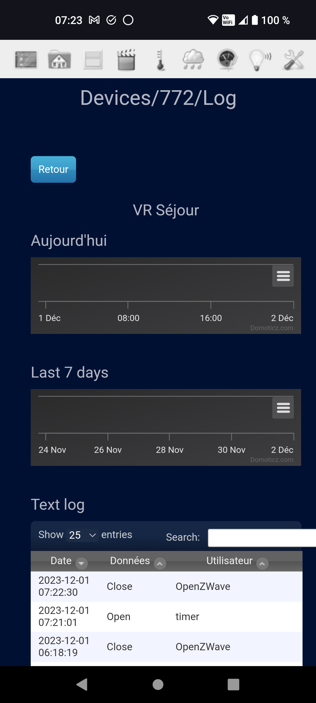

I do have some roller shutters that are programmed to open with a timer.
At set time the open command is sent then a close command is sent by OpenZwave.
Do you have any suggestion regarding this issue?

It could be that the open command is not being accepted/received by the device and it reports back its closed status in Domoticz.
Do you see the blind go open when triggered by the timer?
By the way you are using OpenZwave which will be remove from the next stable release!! You will have to move to Zwave-JS-UI very quickly

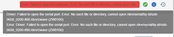

What is in your docker compose file in section devices.
Should be something like below. Change /dev/serial/by-id/insert_stick_reference_here into the real name on you system.
Do the following command in a terminal window to find the correct USB name
devices section Docker compose Zwave-JS-UI
ls -lah /dev/serial/by-idCode: Select all
devices:
# Do not use /dev/ttyUSBX serial devices, as those mappings can change over time.
# Instead, use the /dev/serial/by-id/X serial device for your Z-Wave stick.
- '/dev/serial/by-id/insert_stick_reference_here:/dev/zwave'Domoticz running on Udoo X86 (on Ubuntu)

I did modify Docker compose file, but still encounter an error.
I have stopped Domoticz to be sure it is not connected to the zwave stick, restarted Zwave-JS-ui but still have the error from attached image.
I tried both /dev/serial/by-id/usb-0658_0200-if00:/dev/zwave and /dev/serial/by-id/usb-0658_0200-if00 within the ZWave section of GUI.
The directory looks to be the right one? Maybe access rights?
