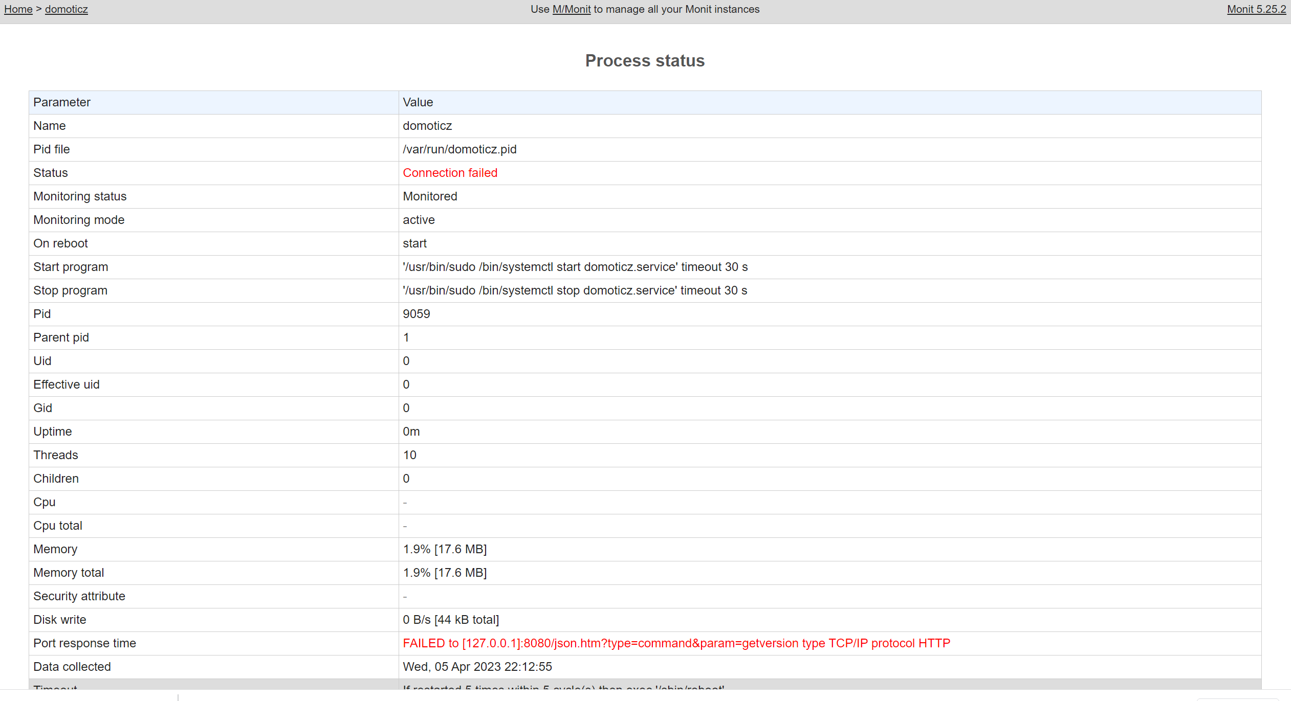

hello all,
one way or another but Domoticz main crashes after prox 10 hours since i have been struggling with master/slave RPI.
I cannot find the reason so installed Monit for help.
But the webpage shows domoticz not connected. I have checked the setting in security trusted network and 127.0.0.1 is present.
any idea
(2 x RPI and a boatload of ESPeasy)
