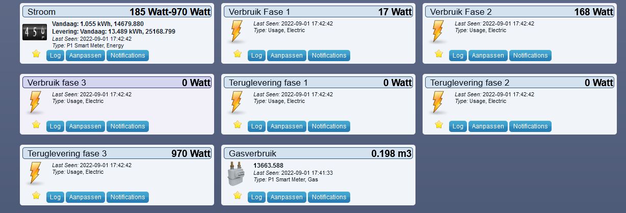

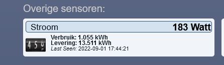

Usually the p1 smart meter data, show the power sent to the grid, minus the power used and that very moment.
Recently I saw that the widget on the Utility page shows both,
and the counter on the dashboard switches between the two, every now and then (can't quite count seconds/minutes of it switching but when if f5 the page it FIRST shows usage, and then switches to kwh sent)
stroom 2.JPG (18.08 KiB) Viewed 717 times
stroom 1.JPG (15.37 KiB) Viewed 717 times
Anyway: i was wondering if anybody has ever seen that behaviour, and what might be done about it.

I can confirm that on latest beta I see the same behaviour, only one of the usage/return values are mentioned. In mobile layout I see both values....
Does your mother also has a recent version?
