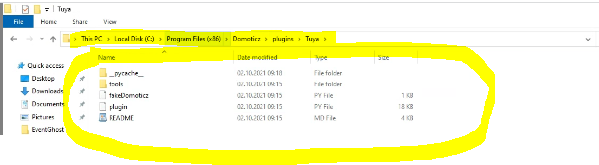

Hello i am trying to get Tuya plugin to work, but I am stuck now
I am using windows 10 PC,
About Domoticz
Version: 2021.1 (build 13669) (beta)
Build Hash: f30dc726c
Compile Date: 2021-10-01 18:47:35
dzVents Version: 3.1.8
Python Version: 3.5.2 (v3.5.2:4def2a2901a5, Jun 25 2016, 22:01:18) [MSC v.1900 32 bit (Intel)]
Domoticz find my Python but when I try to open Tuya plugin i get this error message:
Also a guestion, do I need gateway to make this work?
About Domoticz
2021-10-02 09:08:02.221 Error: Smartlife: (tuya) failed to load 'plugin.py', Python Path used was 'C:\Program Files (x86)\Domoticz\plugins\tuyaha-master\;C:\Program Files (x86)\Python35-32\python35.zip;C:\Program Files (x86)\Python35-32\Lib\;C:\Program Files (x86)\Python35-32\DLLs\;C:\Program Files (x86)\Domoticz;C:\Program Files (x86)\Python35-32;C:\Program Files (x86)\Python35-32\lib\site-packages'.
2021-10-02 09:08:02.221 Error: Smartlife: (Smartlife) Module Import failed, exception: 'ImportError'
2021-10-02 09:08:02.221 Error: Smartlife: (Smartlife) Module Import failed: ' Name: requests'
2021-10-02 09:08:02.221 Error: Smartlife: (Smartlife) Error Line details not available.
2021-10-02 09:08:02.221 Error: Smartlife: (Smartlife) Exception traceback:
2021-10-02 09:08:02.221 Error: Smartlife: (Smartlife) ----> Line 57 in 'C:\Program Files (x86)\Domoticz\plugins\tuyaha-master\plugin.py', function <module>
2021-10-02 09:08:02.221 Error: Smartlife: (Smartlife) ----> Line 2 in 'C:\Program Files (x86)\Domoticz\plugins\tuyaha-master\tuyaha\__init__.py', function <module>
2021-10-02 09:08:02.221 Error: Smartlife: (Smartlife) ----> Line 5 in 'C:\Program Files (x86)\Domoticz\plugins\tuyaha-master\tuyaha\tuyaapi.py', function <module>

If you used this Tuya plugin https://github.com/Xenomes/Domoticz-TUYA-Plugin (there are others) you need to install the python module "requests" too.

I did nopt use this plugin. But now I have tried this plugin that you linked me, and installed requests with command promt pr installation guide.waltervl wrote: Saturday 02 October 2021 10:05 If you used this Tuya plugin https://github.com/Xenomes/Domoticz-TUYA-Plugin (there are others) you need to install the python module "requests" too.
And now i get this error:
Could it be that my Tuya devices are not compatible with this plugin?2021-10-02 10:49:41.537 Error: Smart life 2: (tuya) failed to load 'plugin.py', Python Path used was 'C:\Program Files (x86)\Domoticz\plugins\Tuya\;C:\Program Files (x86)\Python35-32\python35.zip;C:\Program Files (x86)\Python35-32\Lib\;C:\Program Files (x86)\Python35-32\DLLs\;C:\Program Files (x86)\Domoticz;C:\Program Files (x86)\Python35-32;C:\Program Files (x86)\Python35-32\lib\site-packages'.
2021-10-02 10:49:41.557 Error: Smart life 2: (Smart life 2) Module Import failed, exception: 'ImportError'
2021-10-02 10:49:41.568 Error: Smart life 2: (Smart life 2) Module Import failed: ' Name: tuyaha'
2021-10-02 10:49:41.638 Error: Smart life 2: (Smart life 2) Error Line details not available.
2021-10-02 10:49:41.689 Error: Smart life 2: (Smart life 2) Exception traceback:
2021-10-02 10:49:41.729 Error: Smart life 2: (Smart life 2) ----> Line 65 in 'C:\Program Files (x86)\Domoticz\plugins\Tuya\plugin.py', function <module>
https://www.aliexpress.com/item/1005002 ... 4c4dCa0nZs

The Tuyaha module is missing, you need to install it see https://github.com/Xenomes/Domoticz-TUY ... stallationkalinkamaen wrote: Saturday 02 October 2021 10:52Code: Select all
That one is unknown, some devices work with the old api some don't.kalinkamaen wrote: Saturday 02 October 2021 10:52 Could it be that my Tuya devices are not compatible with this plugin?

There is install guide for Linux. But I am using windows. WHat and how do I copy paste the files in to plugin directory?Xenomes wrote: Saturday 02 October 2021 15:51The Tuyaha module is missing, you need to install it see https://github.com/Xenomes/Domoticz-TUY ... stallationkalinkamaen wrote: Saturday 02 October 2021 10:52Code: Select all
2021-10-02 10:49:41.568 Error: Smart life 2: (Smart life 2) Module Import failed: ' Name: tuyaha'That one is unknown, some devices work with the old api some don't.kalinkamaen wrote: Saturday 02 October 2021 10:52 Could it be that my Tuya devices are not compatible with this plugin?
Windows 10, Domoticz 14784

You don't need to put something in the plug-in directorykalinkamaen wrote: Saturday 02 October 2021 16:20 There is install guide for Linux. But I am using windows. WHat and how do I copy paste the files in to plugin directory?

Thank you guys, I have managed to make it work.I am a noob so I did not know about pip. I had to download TUYA plugin, put it in directory and pip install it from directory. I was not able to install it from github.Xenomes wrote: Saturday 02 October 2021 19:42You don't need to put something in the plug-in directorykalinkamaen wrote: Saturday 02 October 2021 16:20 There is install guide for Linux. But I am using windows. WHat and how do I copy paste the files in to plugin directory?install pip for python in your windows. https://phoenixnap.com/kb/install-pip-windows then install the modules with the pip install command.
