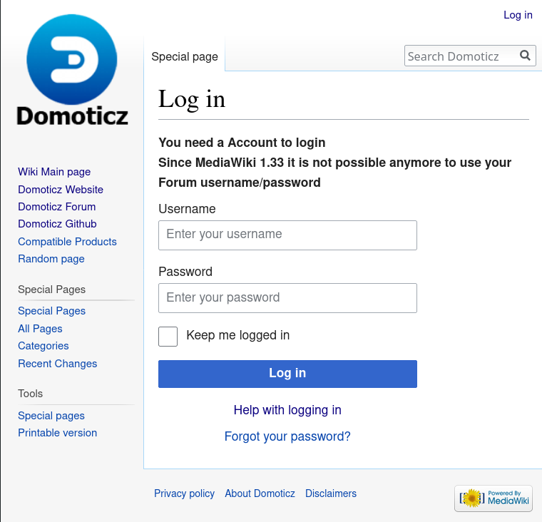

I honestly don't know how to edit this page -- I believe I need to login but it says forum user/pass won't work (and I tried) and there's no 'create account' anywhere that I can see as mentioned in the help login page, so no luck for me.sincze wrote: Saturday 27 June 2020 11:38 Tnx.

I haven't added it to the wiki because my domoticz forum account doesn't work on it and the 'create account' function isn't working for me, so unless someone has a working account and can add it I don't have a way to do it myself. From what I looked at the 'Login' page should have a 'create account' link but it is not anywhere to be found:

I found it, here you can create the requested accountitguy78 wrote: Monday 31 August 2020 3:04
https://www.mediawiki.org/w/index.php?t ... n=loginCTA
