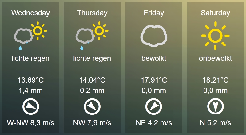

Maybe also get an option to add the wind in the forecast overview as well, below the rain?
Like SW 3 or NO 15m/s etc.
Something like this?
I updated to the latest beta, the wind direction add-on is great!
Is this new wind feature also implemented in the weather layout type 3? Or are there new extra options/parameters there as well?

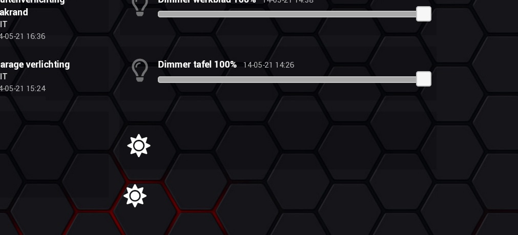

I got it working on three devices, my laptop, my phone, an small 10" tablet but on my 13" tablet I can only see an small icon where the weather should show up. Anybody has some toughts about this?
I did nothing with screen settings in the config, I tried it but did not had any results. Except my laptop all my other devices are Android devices.

jacobsentertainment wrote: Friday 14 May 2021 16:32 Hi all,
Try to clear the cache and reload.
I’ve the same sometime and this works for me
jacobsentertainment
Posts: 223
Joined: Thursday 01 October 2020 1:47
Domoticz version: 2021-1
Location: Not @ home
Re: Dashticz v3.8.2 beta: New weather block
Post by jacobsentertainment »
madpatrick wrote: Friday 14 May 2021 16:37 Try to clear the cache and reload.
:cry: No didn't work. I even installed Chrome :o
Tested out on several browsers:
  • Old android browser: works but then my "dial" type temperature doesn't seem to be working
  • Opera: Everything except the weather works.
  • Chrome : Same as the Opera browser.
  • Firefox can't be installed (no support)
  • Edge: same problem and some silly other browser to....

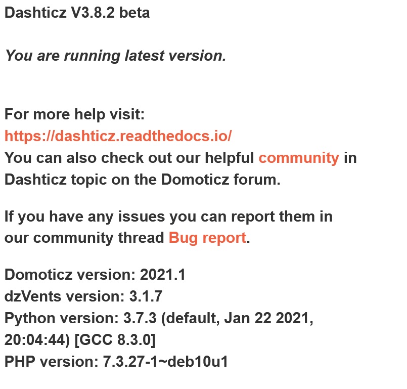

Double check that you are running Dashticz 3.8.2 or higher (it's reported if you click on the Dashticz settings icon, upper right)
Can you post your CONFIG.js?

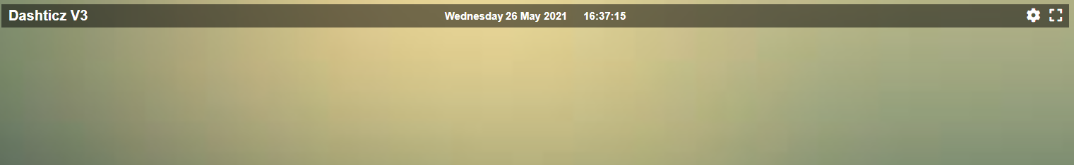

I tested the thing below but nothing is showing!
var config = {}
config['domoticz_ip'] = 'http://192.168.1.xxx:xxxx';
config['app_title'] = 'Dashticz V3';
config['login_timeout'] = '60';
config['user_name'] = 'xxxxx';
config['pass_word'] = 'xxxxxx';
config['use_favorites'] = 1; //Request all Domoticz Devices, not only favorites
config['auto_positioning'] = 0; // Use 0 this if you have defined your own columns
config['owm_api'] = '5xxxxxxxxxxxxxxxxxxxxxxxxxxxxxx2';
config['owm_city'] = 'xxxxx';
config['owm_name'] = 'Météo xxxxx';
config['owm_country'] = 'be';
config['owm_cnt'] = '4';
config['owm_days'] = 1; // Enter 1 for showing forecast in days, 0 for the OWM default 3 hour forecast
config['owm_lang'] = 'fr'; // Set language for de description of the forecast (rain, cloudy, etc.). For available languages, see https://openweathermap.org/forecast5/#multi
config['owm_min'] = 1; // Enter 1 to show min temperature on 2nd row
config['static_weathericons'] = 0; // Static or 'moving' weather icons
//Definition of blocks
blocks = {}
blocks['weather'] = {
type: 'weather',
apikey: '5xxxxxxxxxxxxxxxxxxxxxxxxxxxxxx2', //Your OpenWeatherMap API key
city: 'xxxxx',
country: 'be',
lang: 'fr',
layout: 0, //Daily forecast
width: 12,
count: 3,
refresh: 1800,
static_weathericons: false,
decimals: 2,
showRain: true,
showDescription: true
//Definition of columns
columns = {}
columns[1] = {
 blocks : ['weather'],
 width : 8
An idea ?

Try this code:
var config = {}
config['domoticz_ip'] = '192.168.1.4;
config['user_name'] = 'user';
config['pass_word'] = 'pasword';
config['use_favorites'] = 0; //Request all Domoticz Devices, not only favorites
config['owm_api'] = ''1234567890';
config['owm_city'] = 'Antwerpen';
config['owm_name'] = 'Antwerpen';
blocks = {}
blocks['weather_0'] = {
type: 'weather',
width: 12,
refresh: 1800,
decimals: 2,
showRain: true,
columns[1] = {};
columns[1]['blocks'] = ['weather_0'];
columns[1]['width'] = 8;
var screens = {}
screens[1] = {}
screens[1]['columns'] = [1];
Dz-beta | Dashticz 3.8.10 BETA | Tradfri | RF-Link | Z-Wave | Harmony | Unify | P1 |
Doudy
Posts: 246
Joined: Tuesday 09 August 2016 9:09
Post by Doudy »
@Dickey
I tried your version but nothing is showing :?

@Doudy
Can you add the following line with code before your columns in your config.js:
var columns = {}
And change blocks = {} to
var blocks = {}
Tried the follwing code and is working here. Can you try and change <your_own_setting> to your own settings:
var config = {}
config['domoticz_ip'] = '<your_own_setting>';
config['owm_api'] = '<your_own_setting>';
config['owm_city'] = '<your_own_setting>';
config['owm_name'] = '<your_own_setting>';
config['owm_country'] = 'nl';
config['owm_lang'] = 'nl';
var blocks = {}
type: 'weather',
width: 12,
refresh: 1800,
decimals: 2,
showRain: true,
var columns = {}
columns['bar'] = {}
columns[1] = {}
columns[1]['blocks'] = ['weather']
columns[1]['width'] = 5;
var screens = {}
screens[1] = {}
screens[1]['background'] = 'bg2.jpg';
You should get a page with a block like this:
Naamloos 1.jpg (157.81 KiB) Viewed 2019 times

@HansieNL:I tested the code, and did get the same result as you posted.
That's why i think he have to update Dashticz, course the weather module had a revision.

Dickey wrote: Wednesday 26 May 2021 16:45 What is you're Dasticz version?
See my signature : 3.8.0.2
Dickey wrote: Wednesday 26 May 2021 16:45 Go with terminal into the Dasticz folder and enter the git pull command. You will automatic get the latest version.
pi@raspberrypi-185:~/dev/dashticz $ git pull
Déjà à jour.
