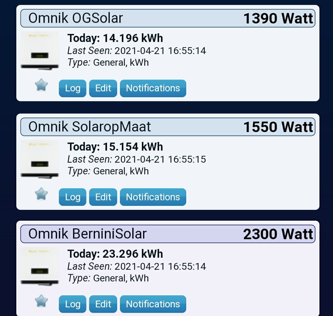

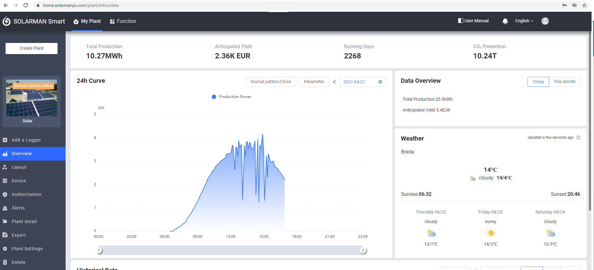

Just received, let's update the thread to see how this goes.
Notification of Omnik platform closure
Dear Users,
As Omnik has been in the liquidation procedure and is not able to pay for the maintenance fees for servers, we are sorry to inform you that this platform will be closed at the end of April. All services including Open API, APP and data forwarding will not be available after the platform is closed. All data saved on current servers will be deleted after the shutdown.
If you wish to continue the monitoring service, you could switch to SOLARMAN platform based on new servers. Data at Omnik platform will be migrated to SOLARMAN servers from 9 a.m. on 19th April, 2021 (UTC+8). Please notice that any operation on Omnik platform from that time will not be synchronized to SOLARMAN platform.
The overall migration process will take about 72 hours. In order to ensure the data integrity and accuracy, please DO NOT modify any data on Omnik platform during this period. If you need to register new accounts during the migration, please log in to SOLARMAN platform (For end-users, please log in https://home.solarmanpv.com; for installers and distributors, please log in https://pro.solarmanpv.com).
You could log in SOLARMAN platform using your current account and password. SOLARMAN will provide three-month free trial for your Omnik devices. During this period, you will be able to use all functions.
SOLARMAN Smart (https://home.solarmanpv.com) is designed for end-users. With new visual experience, user-friendly data display, and well-established monitoring function, SOLARMAN Smart makes smart energy management easier for everyone.
Sorry for the inconvenience and we are looking forward to providing better service for you in the future.
Please feel free to contact us for any questions via [email protected]. For more information and FAQs, please click the 'Service' button on the right side of the following page: https://www.solarman.cn/enservice.html
If you do not wish to migrate your data to the new servers, please contact us for account cancellation.

So it seems my unit is now part of Solarman.
The old environment is also supplying me data so not dead yet.
Pass2php

waltervl wrote: Wednesday 21 April 2021 20:02 I still have a working omnik portal website. I get my data directly from the Omnik inverter so no need for a web portal. But it would be nice if it keeps working... :-)
Yes I've the same (local read-out), however if you monitor for other people that don't have Domoticz ;-) it will become a different ball game in the near future.

It seems Omnik is officially down now. (no data from the webportal anymore, of course local reading of your inverter still possible)
The data is available in Solarman https://home.solarmanpv.com/login.
