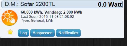

Prepare Domoticz
If you don't know how to create a virtual sensor chances are you have never done this before.
- Go to "Hardware"
- Fill in the name field with a desired name (like "Virtual")
- Choose for type the "Dummy, does nothing, use for virtual switches only"
- Click on "Add"
- The added hardware is now added to the hardware list. In the same row there is a "Create virtual sensor" button shown. Click on it.
Hardware
Now you are ready to create virtual devices.
- Go to "Hardware"
- Press "Create virtual sensor".
- Fill in the name with a desired name (Ginlong, or Omnik Solar for example)
Devices
Now you are ready to create a devices.
- Go to "Devices"
- Press click on the green arrow at the right on the newly added device.

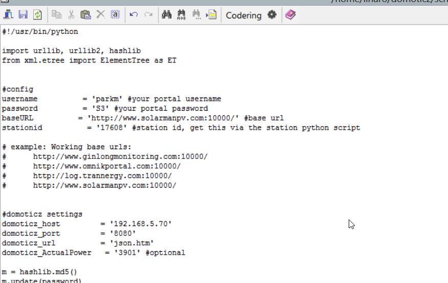

Why not making all in 1 device? a energy device wil porvide an actual usage and a "today" in the counter below if you uploaded the total counter it will supply a today counter. see my pic.
and the euros will also display in de report of that specific device..
with api call /json.htm?type=command&param=udevice&idx=IDX&nvalue=0&svalue=POWER;ENERGY
Power is current wattage
energy is total energy generated
ive edited the code, maybe you want it.
