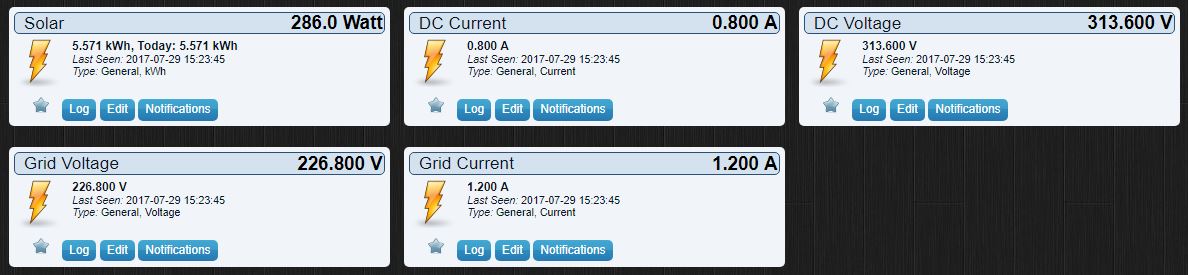

Getting Info...
TodayIncome: 6.918
ActualPower: 872.00
etoday: 30.08
etotal: 14534.0
etotal 1000: 14534000.0
Well if we are this far with the python script it should be possible to get it working as an official hardware plugin in domoticz right? :D

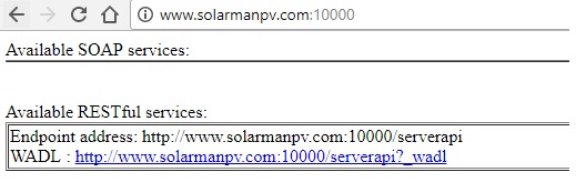

Mmm what happens if you change:
baseURL = 'www.solarmanpv.com/' #base url
to:
baseURL = 'http://www.solarmanpv.com' #base url

If you open:http://www.solarmanpv.com:10000/

Remove port 10000, you don't need to writ it.

Currently working on the Shinemonitor and able to retrieve the following data from their API.
I was able to retrieve the data using PHP and Python3.
Why Python3. well I'm trying to figure out how to build a native-domoticz plugin :D and that one seems to require Python3.
Pass2php
USB: RFXCom, ZWave, Sonoff 3
MQTT: ZIgbee2MQTT,
ZWAVE: Zwave-JS-UI
Solar: Omnik, PVOutput
Sensors: You name it I got 1.
devros
Posts: 183
Joined: Saturday 29 October 2016 20:55
Re: Ginlong, Omnik Solar, Solarman and Trannergy Inverters
Post by devros »
wow you made my day :) thanks a lot
thats perfect news..., i did my own python sihinemonitor scraper, but is really buggy and works only for current watt. Can you share script that you already have? Im quite curios how did you managed to get json data.
Native domoticz plugin is not so important but would be also great.
BTW: Did you noticed, that shinemonitor.com have quite often conection problems (error 502) ?
sincze
Posts: 1302
Domoticz version: 2024.4
Post by sincze »
devros wrote:wow you made my day :) thanks a lot
:D That was the idea.
devros wrote:thats perfect news..., i did my own python sihinemonitor scraper, but is really buggy and works only for current watt. Can you share script that you already have? Im quite curios how did you managed to get json data.
Well at the moment my script is in as-is fase meaning you need to enter a lot of values or login to the shinemonitor website to retrieve a few. The guy on the other side of the world is implementing http://api.shinemonitor.com, but he speaks Chineese.
usr=''				#your username
pwd=''			#your password
companykey=''		#your companykey
# needed to retrieve data, can be obtained from portal
pn=''				#your plant id
sn=''				#your serial number
devros wrote: BTW: Did you noticed, that shinemonitor.com have quite often conection problems (error 502) ?
O yes I did, first I thought that it was me, but they are experiencing some problems and are working on it.
And now the piece you have been waiting for.

So forum member devros and myself have been playing around to see if we could modify the initial shinemonitor script in such a way that it should work for all kinds of inverters that report their data to shinemonitor.
Kudo's to the devros and his wireshark skills. :D
Pay special attention to the following values:
pn= on your wifi stick or can be found on the shinemonitor portal after signing in the regular way
sn= the serial number of your inverter. Can also be found on the official portal
devcode= this tricky number you have to extract using for example chrome f12 (under network) to see an initial string between your browser and shinemonitor. It seems every brand has its own devcode.
Just run with Python3 as cronjob every 5 minutes or so.
Have fun!!.
