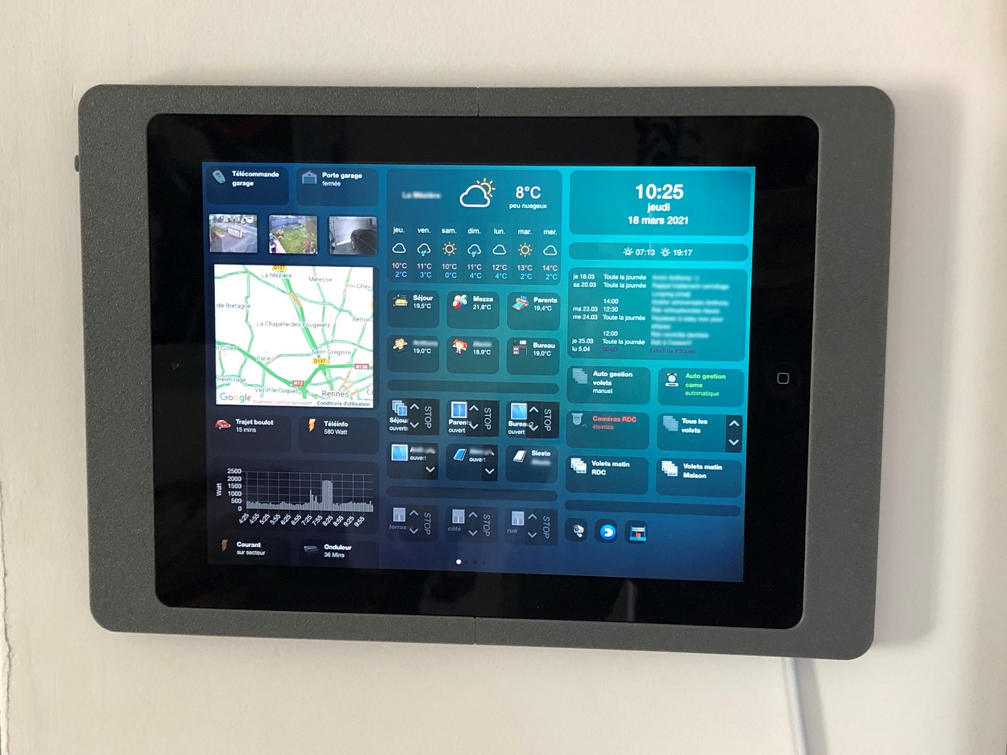

Hi guys,
After a long period to read the very complete tutorial and read you all, thank's a lot to the devs for their work! 8-)
I present you my board on my iPad 2, mounted on the wall with a support 3d printed ;)
MyDashticz on the wall (for forum).jpg (378.18 KiB) Viewed 2675 times
I use "Kiosk Browser for iPad" (better than a "shortcut of the dashticz page on the home page" which displays a useless bar with the battery)
But I still have a few questions that I summarized here: :)

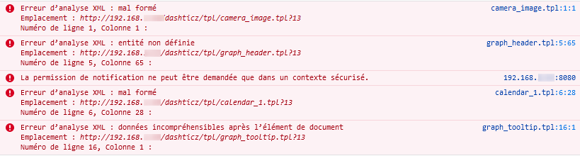

errors: I have a few errors with the dev tool, see the screenshot, what is wrong in my config? :arrow: just warnings
A few errors in DevTools of Firefox
Few errors.png (20.02 KiB) Viewed 2675 times
Not really an issue. Your system tries to interprete the .tpl files as .xml files, but that doesn't work. You have this on firefox?
